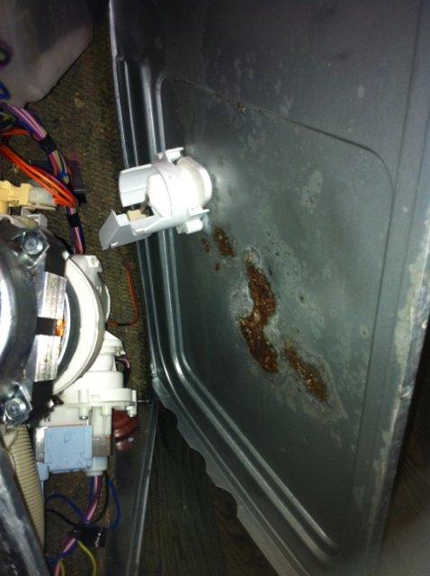

First of all tilt it forward and drain any water from the base. You can remove the base and inspect for any loose hoses , leave it for 48 hrs to dry out then try it.

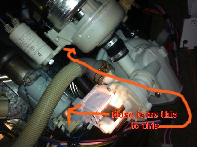

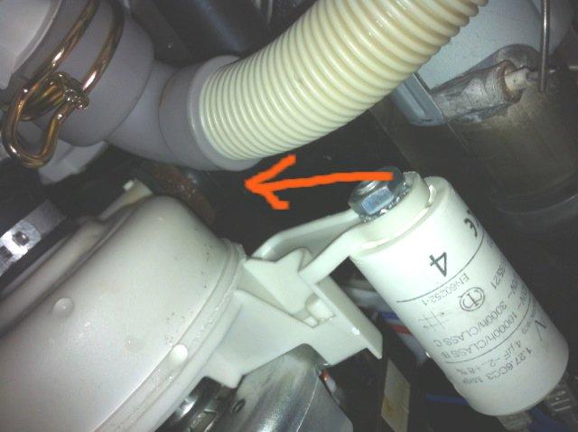

OK I've tipped it on its side and taken the bottom off - yes it looks like this is indeed the problem - I've attached some pics, the first you will see a rusty patch on the base where it must have been dripping for some time. I can just about see right up into the middle of the insides there is a host with rust around the top so I suspect this is where it is leaking, it looks a bit difficult to get to (well for me anyway) but possibly could be fixable at not too much cost? The rest of the hoses and connections all look really new so maybe just a bit unlucky with this?
I have tried to show on the one of the photos where the rusty bit is on the hose and then zoomed out a bit to try and show which bit the hose is joining, apologies I don't know what the parts are called.
I'd be grateful for any more advice on this.
