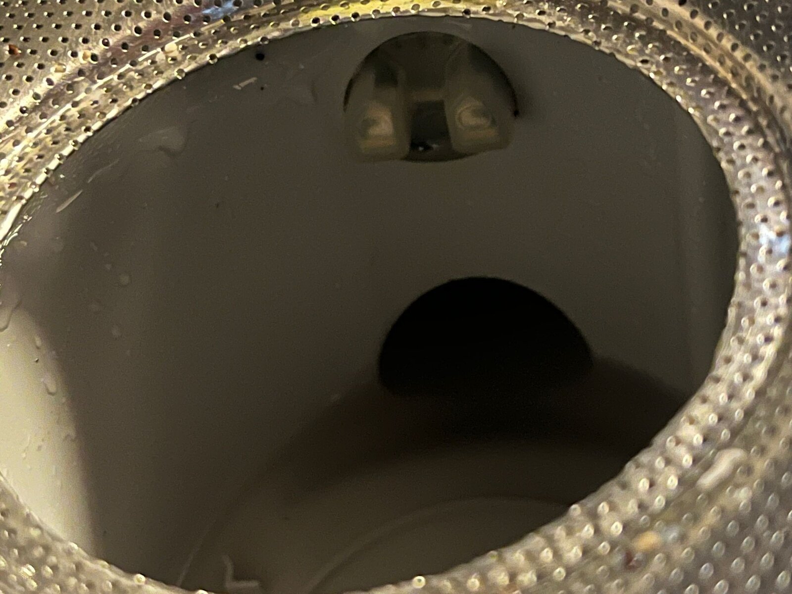

Hello guys,
I have an Ariston LDFA+ 12H141 dish washer, and it started to show the F5 error, today I checked the drainage for clogs, all looks good, and started playing with manually filling the machine with water, 2 - 3 liters at a time, it drains the water very fast, the pump is ok 100%.
I have looked for the level sensor as mentioned by @Harry but there is no pipe inside, there is some kind of sensor in the middle-bottom part of the dishwasher, is this a new type of level sensor maybe ?
I noticed that the machine stops after it's starting to fill in the water, it's slowly comming in trough the hole on the left side wall, and after about 2 minutes it stops, the F5 error is shown and than it drains the water while displaying the f5 Error
Any advices ?
I fixed the F5 error on the Ariston dishwasher by blowing air trough a drinking straw, after I removed the tube that leads to the pressure sensor.
The sensor was functioning correctly. Everything can be fixed just by leaning the machine about 35 degrees on the backside, just enough to be able to remove the bottom plastic cover, than the sensor is on the right side and the flexible tube goes up, than to the front of the dishwasher, I removed the flexible tube from the reservoir, testing the sensor by blowing trough the flexible tube. Everything was fine.
Than with another tube or with a longer drinking straw blow in the reservoir, this did the trick. I just used the machine twice without any problem since I fixed it.
