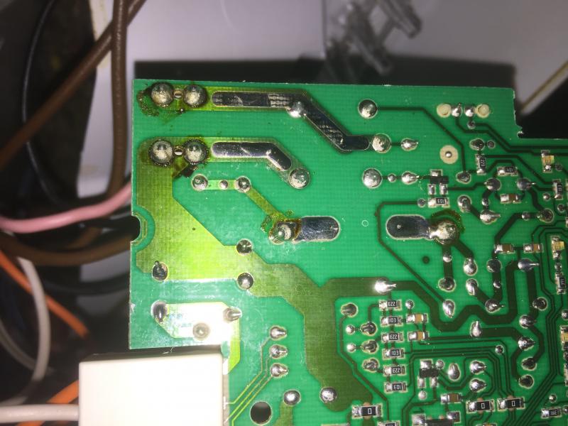

Hotpoint FDW60 Dishwasher PCB
2 Dec 2014
Birmingham
Hi - I've got an FDW60 dishwasher which has stopped heating up the water. Before pulling the thing out and testing the heater element itself I checked the control module after reading an excellent post by kyle123uk. He mentions changing the black relay and a zener diode if you have heating issues.
However, looking at the back of the PCB there are burn marks on the four contacts that take/distribute (?) power (FST1 and FST2) and also the on the two contacts for the large blue capacitor (B81130 X2 MKP/SH 40/100/21/B). I presume this capacitor needs changing but can't find any online.
Any advice on how to proceed would be very much appreciated. Not sure if there's a similar part that can be used or whether it's better to use one of the ebay repair services for £25.00?
