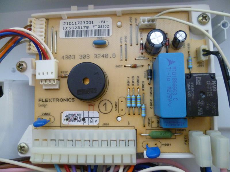

See below for photo of the main control board in case this is what you mean.

There is indeed a microswitch, which is attached to a fuse and it's this fuse which seems to have gone.
Pic 1: http://i55.tinypic.com/244u0pd.gif
Pic 2: http://i53.tinypic.com/4rx4lk.gif
That looks a bit suspicious to me...
