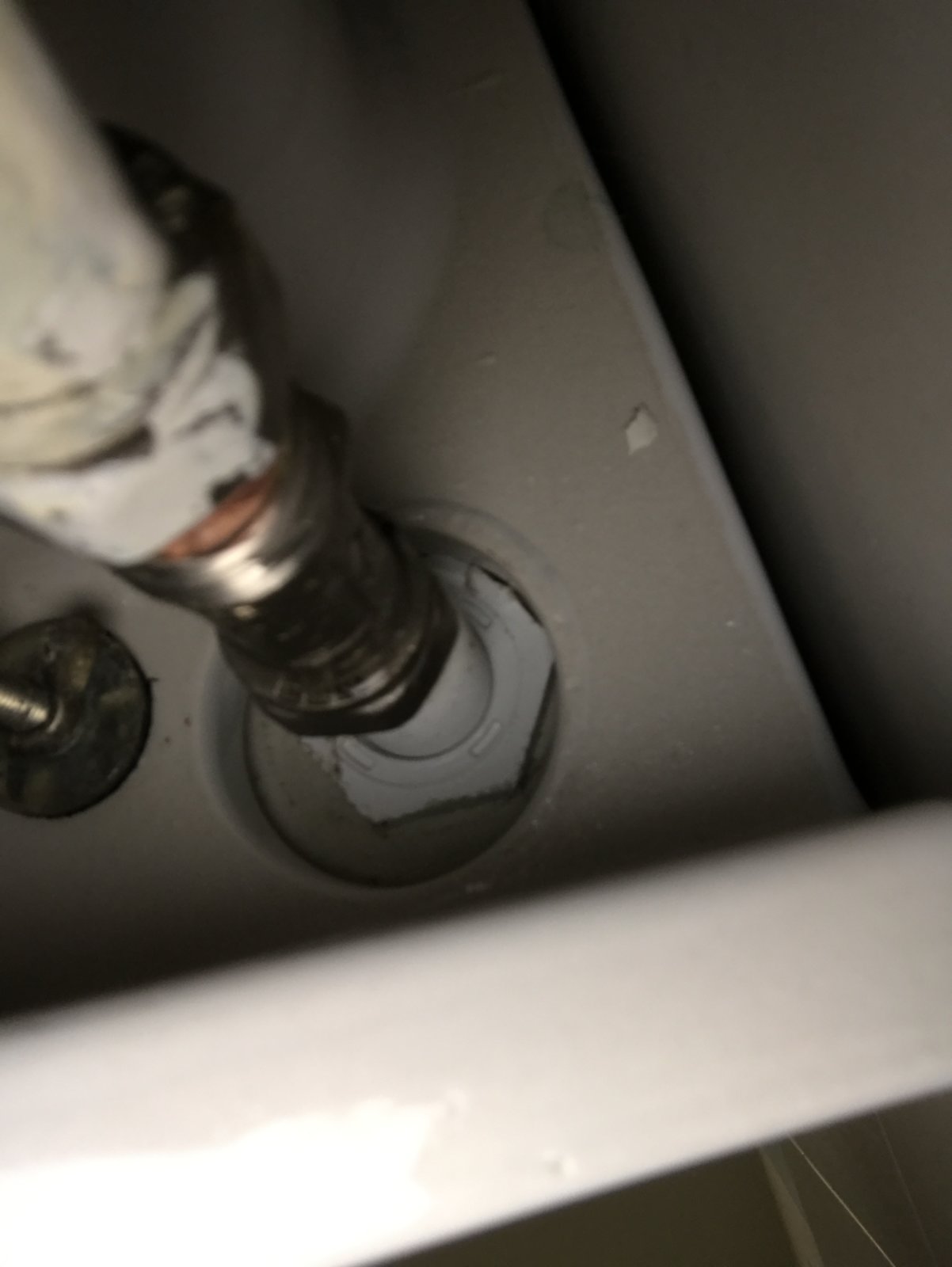

I'm trying to replace the full valve on my Ideal Standard toilet
I've unscrewed the screw connecting the pipe, but the plastic screw washer holding the valve in place is recessed in a small hole, with very little space, in an already hard to access blind back of the toilet...
How the hell am I supposed to unscrew that?!
that's the underneath, looking up?
How does it look on the inside, looking down?
It might be necessary to remove the cistern :(
Take the cistern off by removing the wingnuts on the other fixing you can see in the picture.
Can you turn the body of the Fill Valve inside the cistern - maybe wedging a screwdriver in the recess underneath, outside the cistern . Then get a tap backnut ( smaller hex but same size washer ) and a box spanner to tighten backnut on the new Fill Valve - get one with a brass shank. I don't like splitting cistern/pans unless absolutely necessary.
