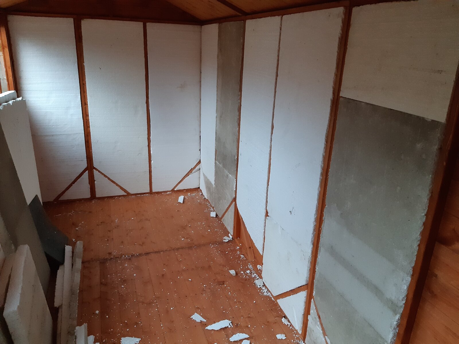

How best to clad this please?
24 Oct 2007
272
43
Berkshire
Hi there, the insulation board is slightly proud of the battens. It's a 20x6 shed. I could use wardrobe backing board to clad, any other suggestions please?
Hi,
Perhaps some OSB?
Not cheap, but would add to the sheds structural rigidity, and would allow shelves etc. to be firmly secured?
It may depend on your use and budget! :)
11mm osb, rip some to strips to fix to uprights to deepen for board fix.Them you can fix shelf or anything else anywhere .
