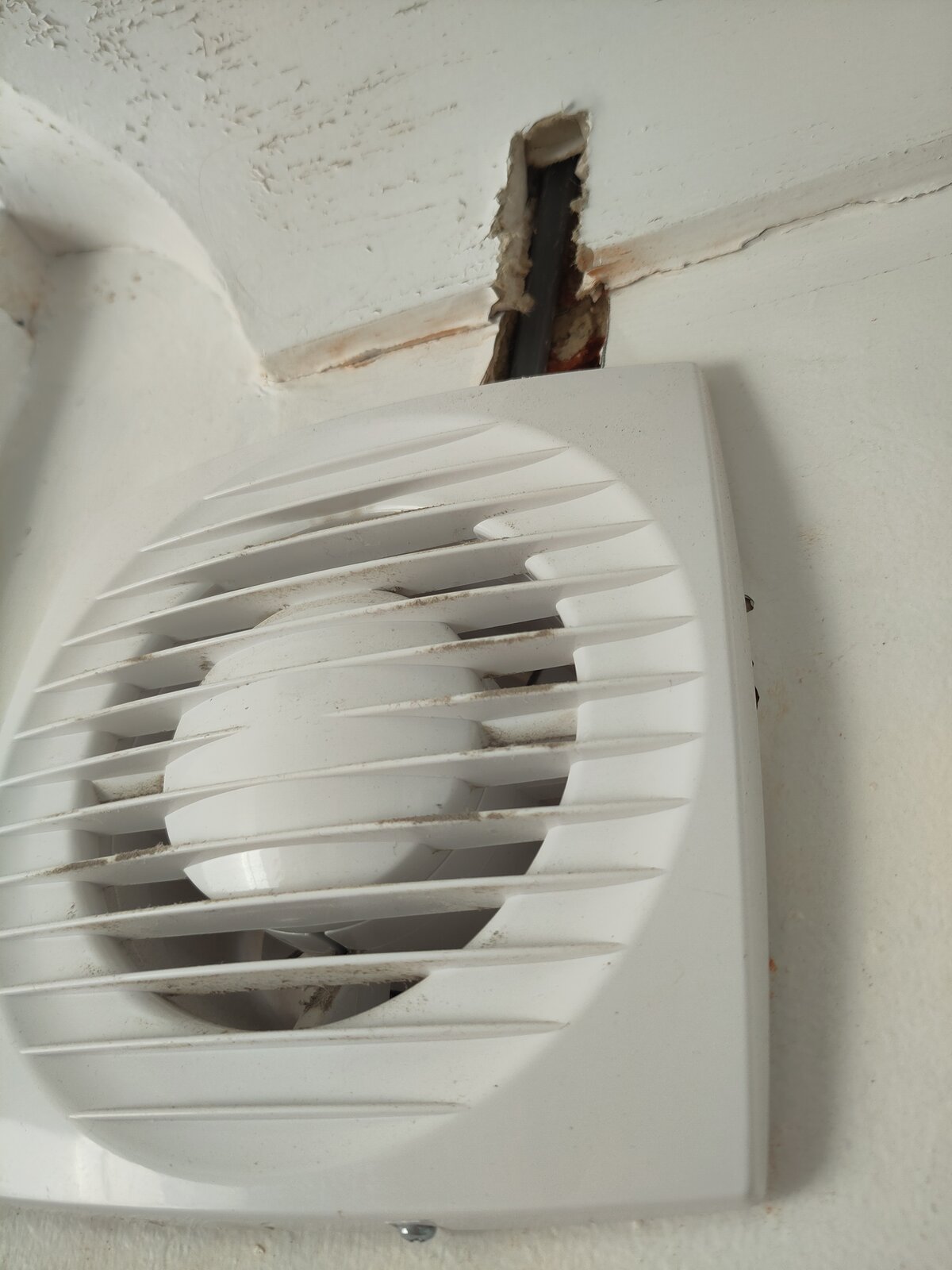

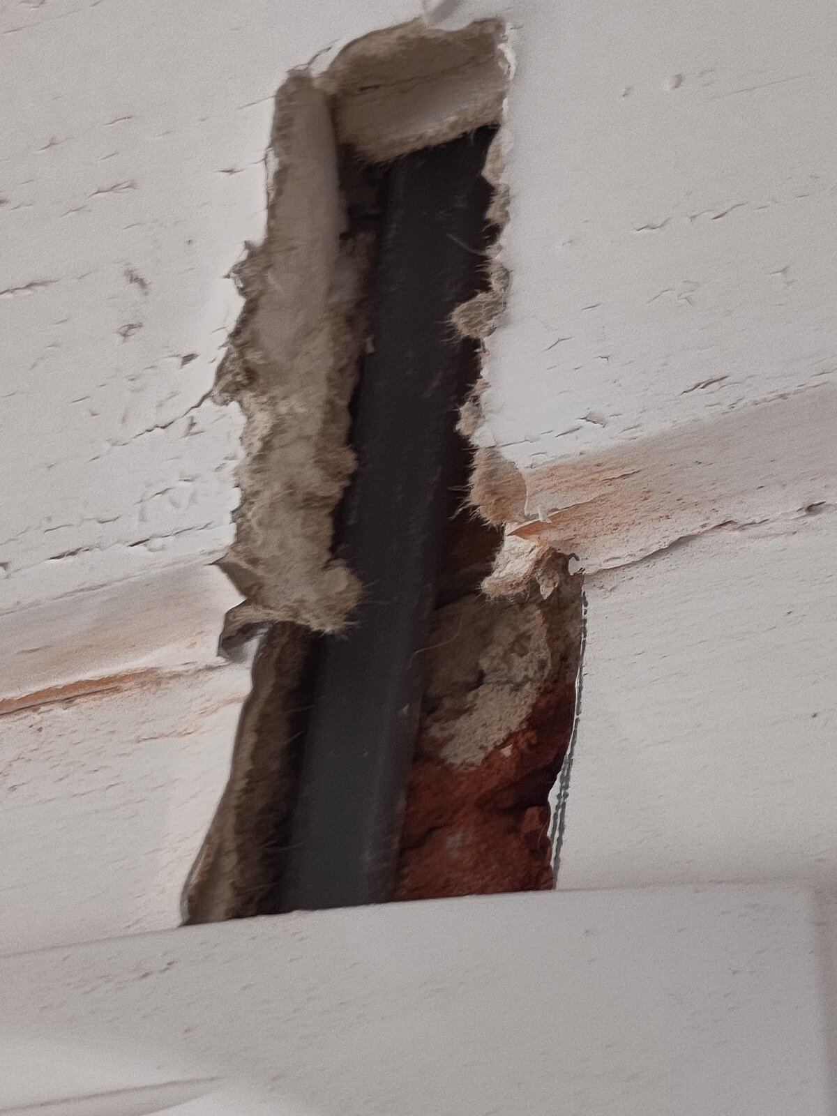

How best to fil this gap?
9 Oct 2024
7
We recently had an extractor fan fitted in our bathroom. Some of the plaster and some of the cornice had to be cut away to access the wire. Now I am wondering how best to fill this gap in the plaster/cornice to cover the wire, its a couple of cm thick. I guess this is too thick for a regular filler like polyfilla, so would I be best off using some kind of two pack filler here? Any recommendations?

Got any wood glue? It's PVA. Mix with 4 parts water and seal cove and wall.
Toupret will fill that. May take 3 small mixes allowing an hour for each mix set before filling again...
Sand when dry...
If you do a nice job you won't see that hole
OK, thanks for that. When you say seal the cove and wall I guess you just mean apply it to the brick and the edges of the cove to make a less porous surface for the filler to adhere to?
I do have a tub of PVA glue - so I would need to thin it with water before applying, I can't just put it on neat?
Toupret interior filler? I have some polyfilla already, would that do the job just as well? If I apply it in stages, waiting for it to dry each stage...
Yes. Seal the edges and bricks with PVA.
Don't use the PVA neat. Better to add water. 50/50 is ok but I prefer 4 to 1.
Seal so filler sticks and done shrink with high suction.
Id use toupret because it's easier to use. Sets nicely and sands nice.
Up to you.
You could possibly first fill with some grip fill or decorators caulk then put your chosen filler over to top
Nope.
The easyfill 45 is completely different product when using it.
Mix. Feel. Use. Drying time. Sanding. How it paints over.
I use tx110 mostly but the the standard toupret powder if fine.
TX110 will have the advantage of drying faster because it has cement in it.
