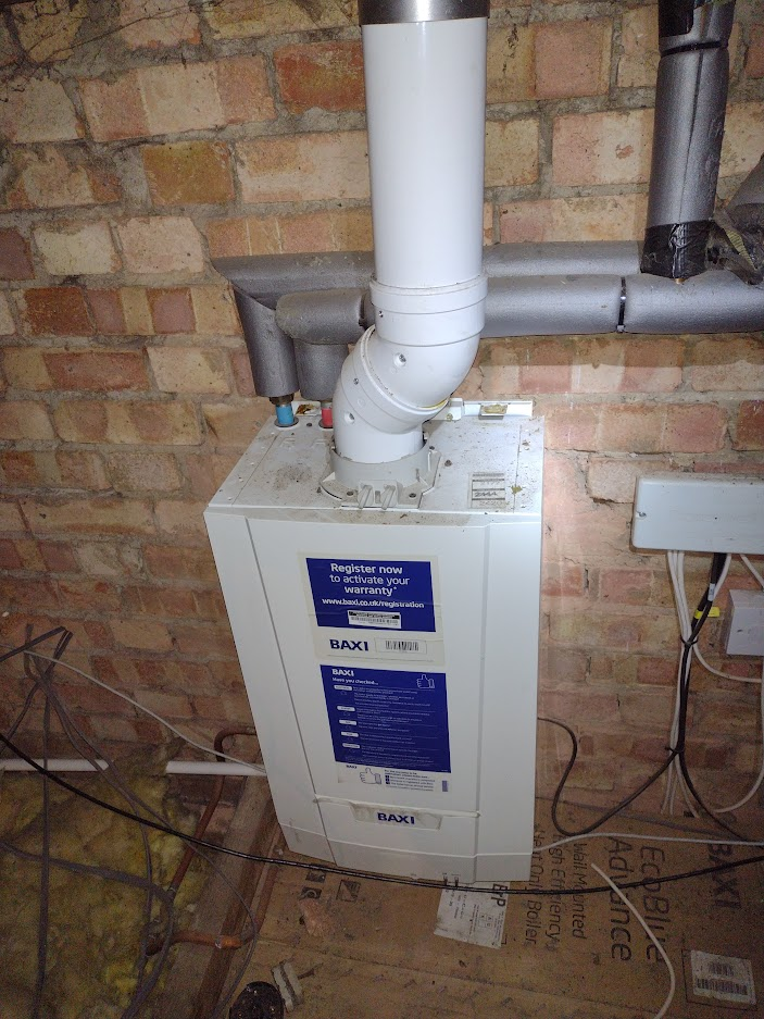

Woke up to a cold house, heating didn't come on.
Flashing red light on boiler.

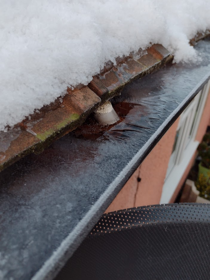

Located condenser pipe, sitting in frozen gutter.
Have fixed it!
But, it's going to keep happening. How to resolve?
Run is very low to ceiling, boiler in the loft. Pipe didn't freeze in loft, which is good.
I guess I should lag the pipe anyway, just to make it less likely to freeze?
Was thinking of trimming the outlet pipe so if gutter frozen the water can still get out.
Can you run the pipe internally to the soil pipe.
External condensate pipe should be 32mm.
Internally with gravity and try to size up to 50mm if in a loft
Yeah, gutters might need improving, had to do a few repairs myself. Usually OK though, first time this has happened in 5 years.

Looks like from Sunday the weather will be mild for a week, so I'll try to clear the gutter and that should be the end of it...
I cut the end of the pipe off so more room for future I've build up too.
