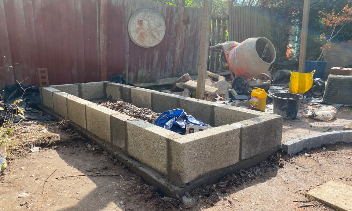

Assuming you’re talking about pouring it into some kind of form work, mortar won’t have the strength and it won’t work.

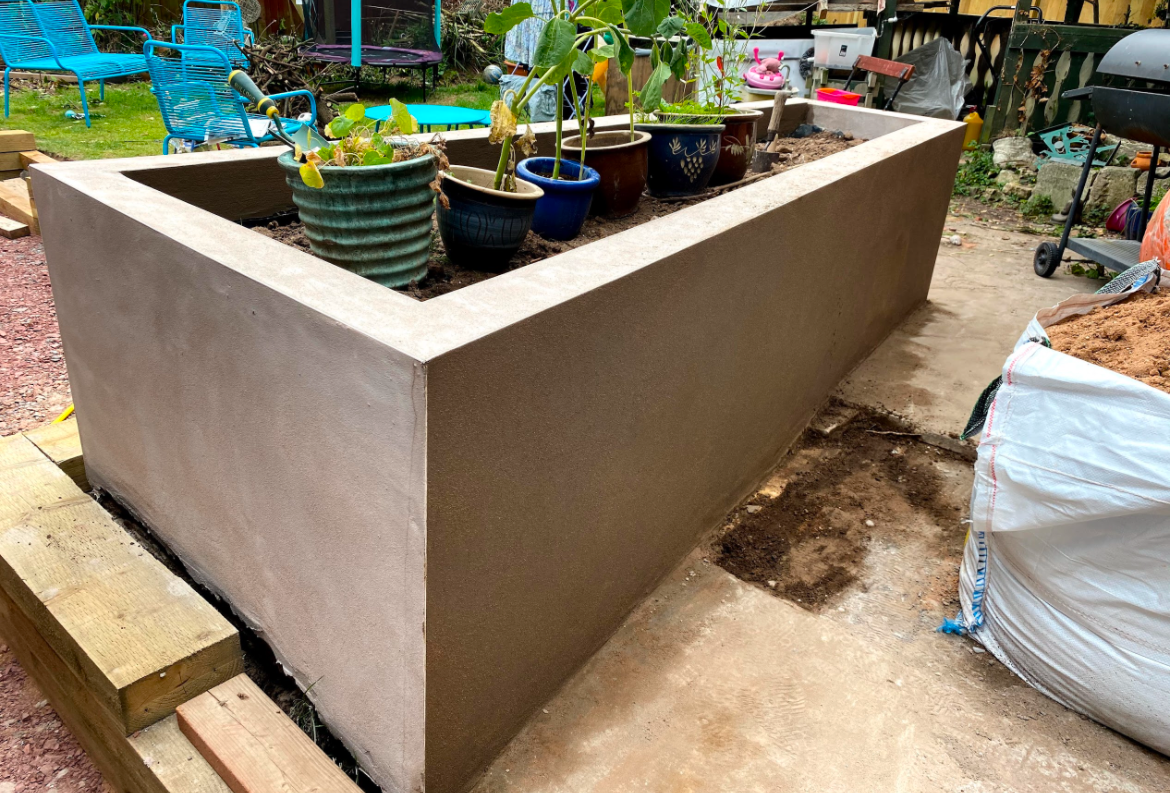

I’ve always done these planters with dense blockwork and render.

excuse my lack of knowledge, but what do you mean by blockwork and render? do you mean the stones (blockwork) and sand (render)?
thank you

ah i see. that is beautiful work! nice job! and you have definitely inspired me to do something like that in the long term. i am going to start looking at how i can fit something like that into my garden :) thank you
