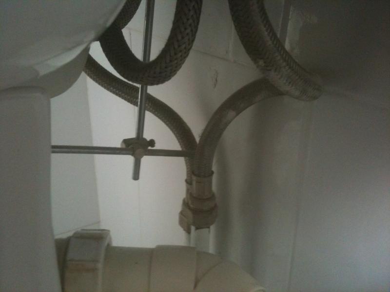

Hi, as can be seen in the pic below, I've got a bathroom basin and I'd like to replace it with a vanity unit. While I'm carrying out the work, what do I use to plug the 15mm flexible tap connectors?

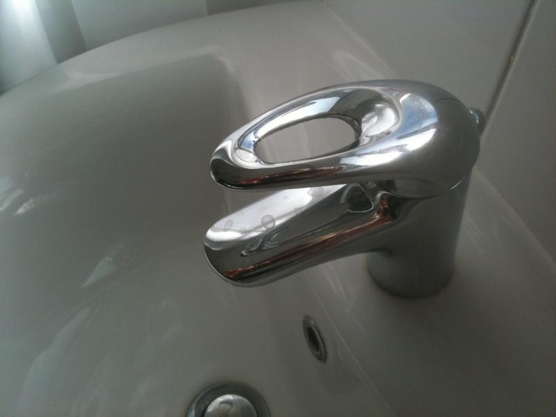

If both of the basins are on the same floor level it is probably due to the fact that the ensuite has high pressure mixer taps fitted (quarter turn ceramic) and the family room has low pressure mixers.
If on the other hand the ensuite is on a floor above then the pressure will be lower because of the reduced head.

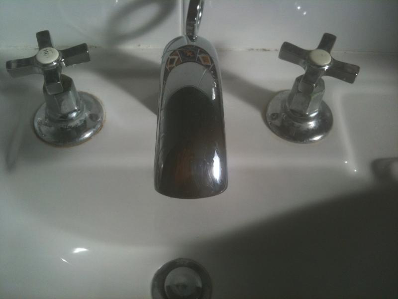

Thanks. They are both on the same floor and pictured below. The first pic is that of the family tap which has a decent flow rate. The second is that of the en-suite tap which as a low flow rate. I wish to replace the latter with a entire new basin and tap. What can I do to ensure a better flow rate? Tap choice?

Family bathroom (good flow rate):
En-suite (low flow rate):
The "bore" of most flexible tap connectors is very small, so they will restrict the flow rate a lot on low pressure supplies. As you've found, copper all the way to the tap usually gives much better results - though requires more skill and time to do.
Choice of tap is also important, as mentioned above. A lot of cheap, imported ones are for high pressure supplies only.
I would install 15mm 1/4-turn isolating valves if not already fitted, so that you can work on the plumbing. Buy "full bore" ones rather than the normal sort. Again, these won't restrict the flow like the standard sort would.
