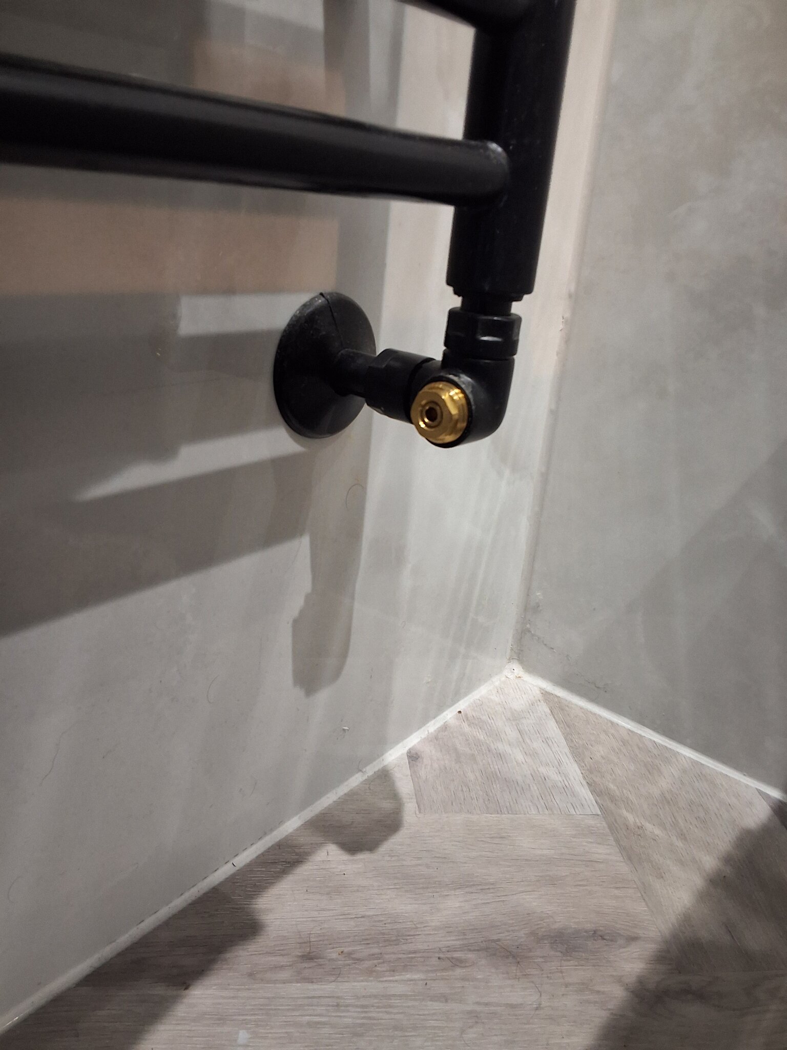

How do I close this type of radiator lockshield valve? It's on a bathroom towel rail and I need to replace the bleed valve.
As above, turn the internal part clockwise with an allen key/screwdriver.
