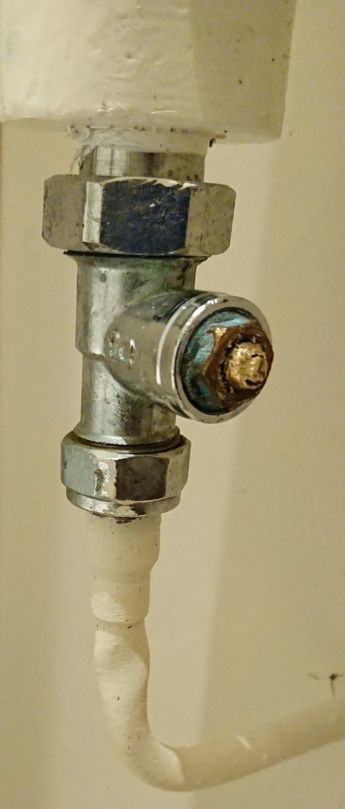

Would you replace this lockshield live? It's on a sealed system. How much of a gush do you get (obviously I will release system pressure first). There is no drain point on this drop so whatever happens there will be some leakage.
The valve was working fine when I closed it to take off the towel rail. The very next day I refitted the towel rail but couldn't open the lockshield. Even soaking it in penetrating oil for 24 hours didn't help. The gland nut came off without issue. I tried to open it with an adjustable and predictably the stem sheared off.
Can you get a lockshield with drain off that would fit in the same space?

Theres not many systems that I drain these days to change a valve and sealed systems make it a doddle to work live. But then again, I’ve been doing it coming up to 20yrs now, you get a feeling for systems that are going to soak you. Turn all the other rads off on their trv/wheelhead, release pressure, towel underneath and job done.
Prep first, work fast.
Thanks, live it is then , closing all the other rads is a good tip.
Yes the pipe appears to be a bit distorted but has been flowing OK so I'm not going to muck about more than I have to.

You have to check that they are the same thread. This could be difficult doing live.
Looking at that picture I think you will be OK with the threads. But that reducer looks to be on the edge.

Done today (finally) without issue. I released the pressure, put a washing up bowl underneath and managed to swap the valve losing less than a litre of water - the towel rail was still glugging as I screwed in the new valve.
I left the old olive and nut on. It seemed a lot easier than trying to bash it off with water pouring everywhere.
