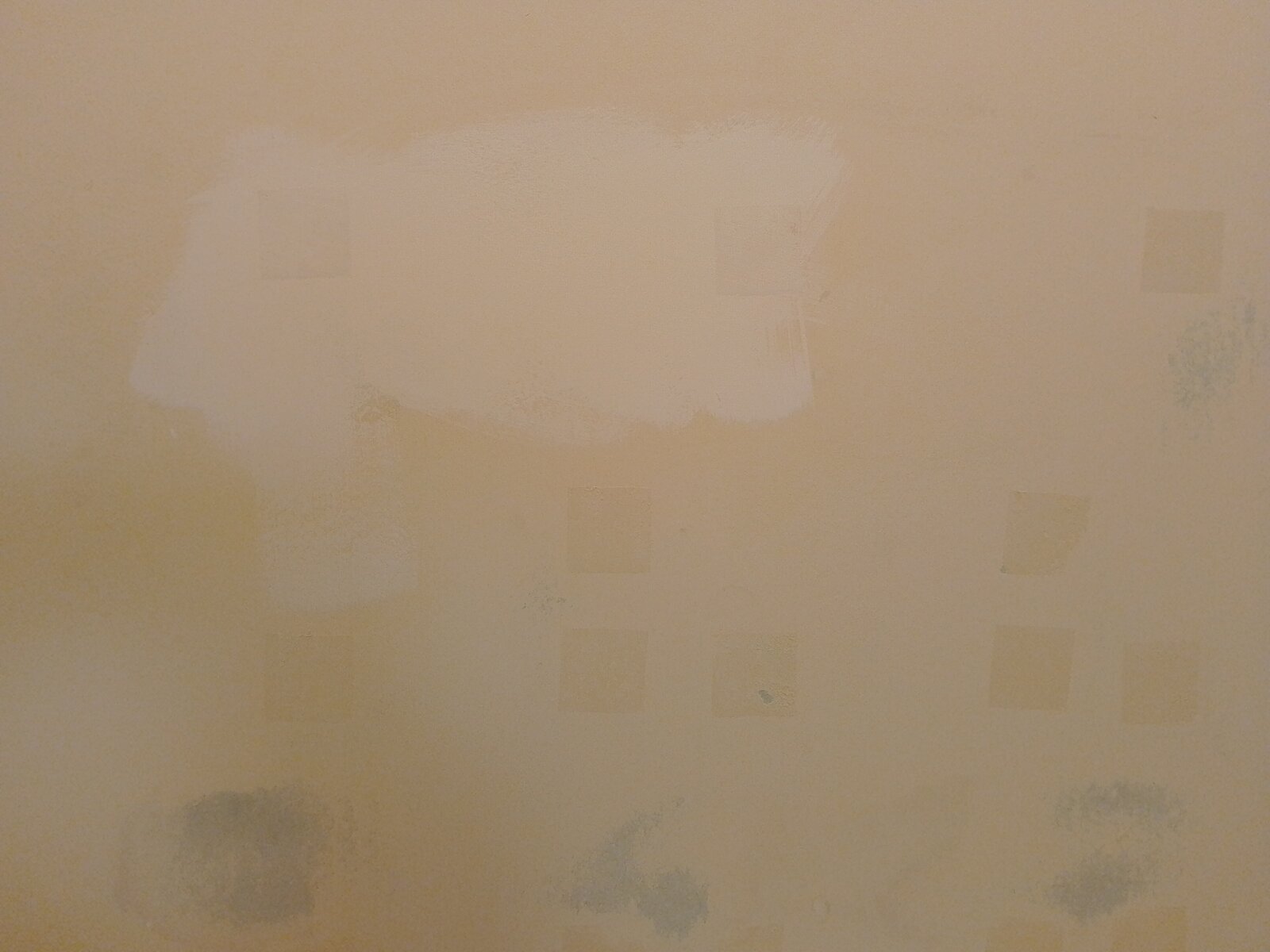

Just bought a flat and the old owners were obsessed with stick on everything, with the worst offenders being stick on mirrors in the bathroom.
I used a hairdryer and scraped off what I could but there is still these square marks of residue. If I try and scrape them any further I reach the green part underneath that you can see. I've tried painting over a couple with Zinsser 123 to see what it looked like but you can see it still shows through.
Any advice?

Multisolve.
Toolstation. B&Q and many other places sell.
Works quickly although stubborn glues give it a minute
