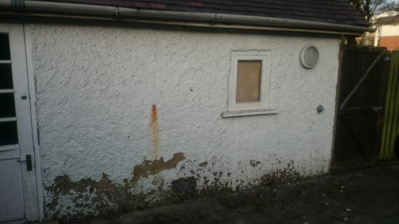

My garage wall is looking terrible. The paint and a thin top coat of tender is flaking off on many places.
How should I best repair this without having to rerender the whole thing? Should I try and just paint over it, or perhaps cover with pva first and then paint it?

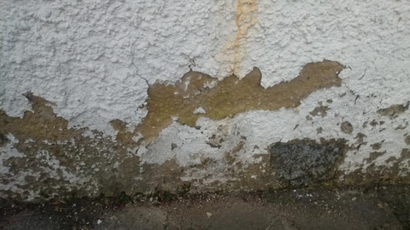

I cant make out if you have badly applied Tyrolean or a dashed coat with plastic paint? Perhaps its the thick layers of plastic paint that are mainly flaking off?
If you are looking for a cheap quick fix then perhaps wash the wall down, then remove all loose and flaky stuff. Cut away the bottom 50mm in ground contact.
Plastic paint is bad for render of any kind but maybe get further advice from the painters forum, and then re-paint the whole wall - dont use any PVA.
Thanks. I can't tell if it is plastic paint. It was already looking like this when we moved in a year ago.
I have normal exterior masonry paint. So it is ok to paint straight into that surface, after I have removed the crumbling parts?
If I hack off the bottom 5cm then how can I make that part look nice? Should I just paint it a different colour?
