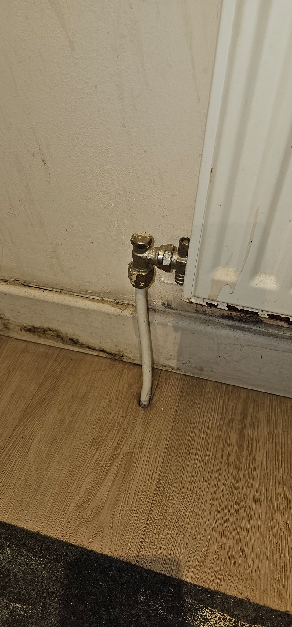

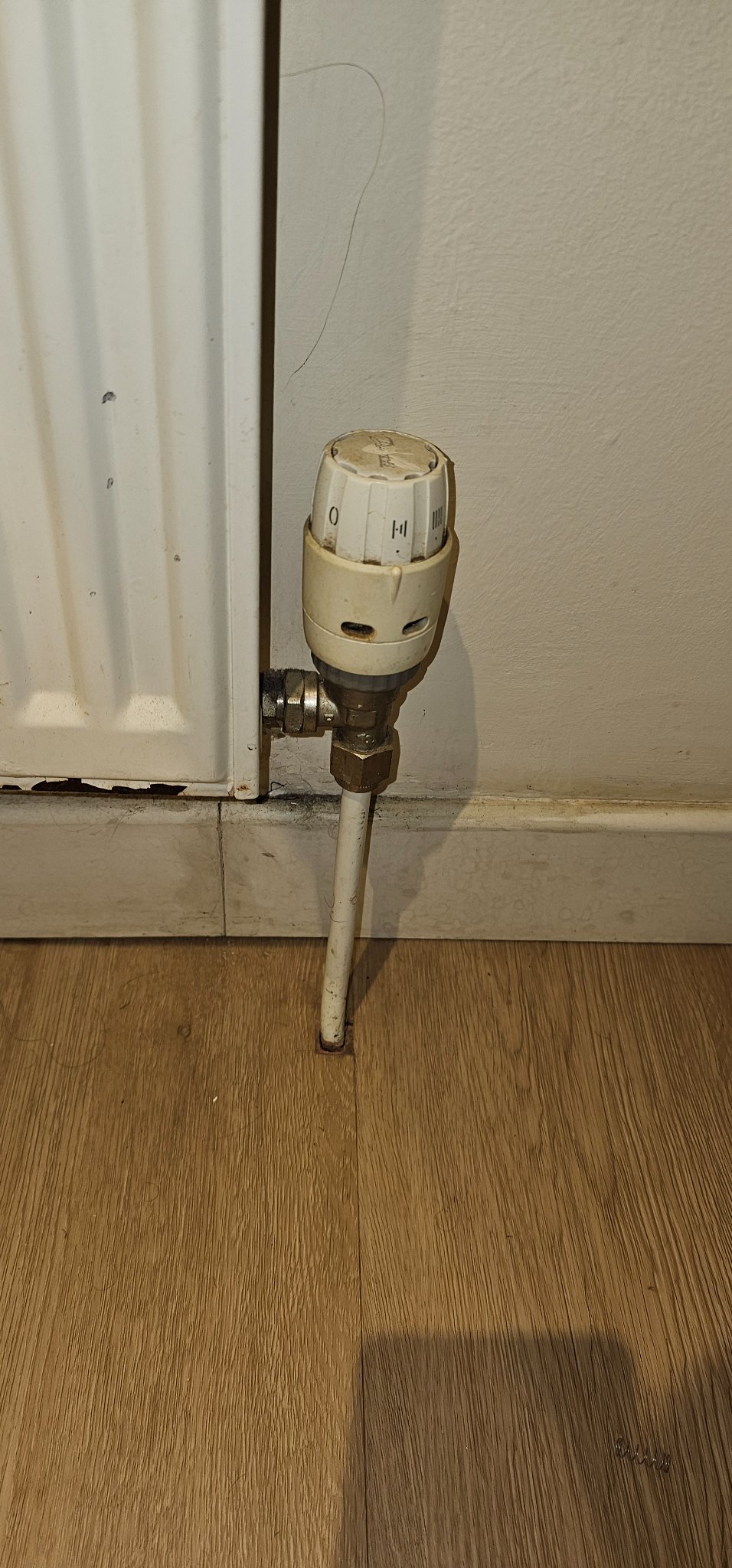

How do i remove this radiator
That's the bottom of the pin and is inside the valve. You won't get a coin in there ;)
I have used a coin many times. I'm speaking from experience.
OK you don't have that experience perhaps. So hush!
The pin is sometimes drawing-pin shaped, witha a bigger flat end, but the action is identical.

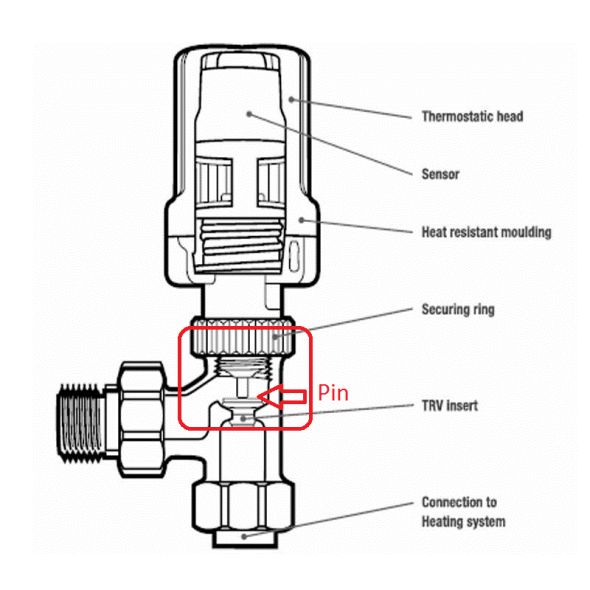

The diagram is NOT wrong - there are many types of trv, they nearly all work on the same principle though.

The diagram is wrong, is my point!
Surely it's obvious to see :idea:
And, no, I won't "hush" how rude.
Just to clear this up and not have a back and forth which I'm not interested in...
... If one was to attempt to put a coin or any other type of spacer, where indicated above by the arrow, one would find themselves getting very wet, and everything around them.
I must admit that if someone mentions the 'pin' as part of a TRV, then I would think about the pin in the valve (usually it's when it's stuck), not so much in the TRV head. TBH - I would usually call the part in the head, that is pushed down by the expanding sensor onto the valve pin, the spindle.
Exactly... The valve is different to the actuator.
