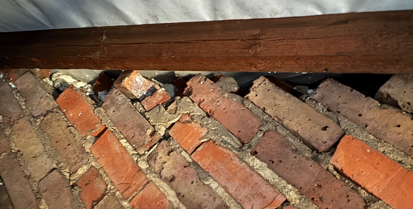

How do i stop birds coming into loft through these gaps?
8 Nov 2024
42
2

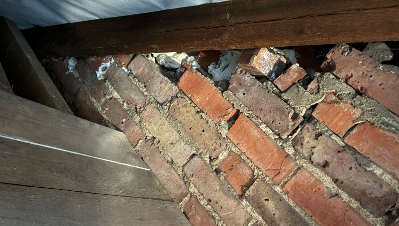

This might be quite a straightforward one i'm hoping. Had a bird trapped in the house the other day, I think it might have got through the gaps in the gable end brickwork. There are a load of them nesting on the outside, it's a solid brick wall. I'm going to try and get someone to brick up the gaps they've left outside in the future, but what about these gaps on the inside?
As you can see i initially reached for the nearest can of expanding foam. But then realising it wasn't the low expansion one got paranoid about it expanding too much and screwing up the very old decaying brickwork and rafters, so raked most of it out. I've got another area like this where I was going to try and put some steel mesh over it, but wondering what the pros do for a proper fix ;).
Cheers guys, i've got some steel mesh on hand for something else. I can see how to tack the top to the last rafter, but how would you go about fixing it to the brickwork? Would a dab of CT1 do the trick or do i need to use plugs and screws?
I wouldn't be drilling into those bricks, they look like they would just push through.
Andy
Thanks, yes the bricks are quite loose and the mortar is very soft. How would you secure the mesh to that side then?
Hot melt glue and CT1 might suffice.
You can double it up with penny washers to hold the mesh in place until the CT1 cures.
Hot melt glue gun- £10-20. CT1 £13
