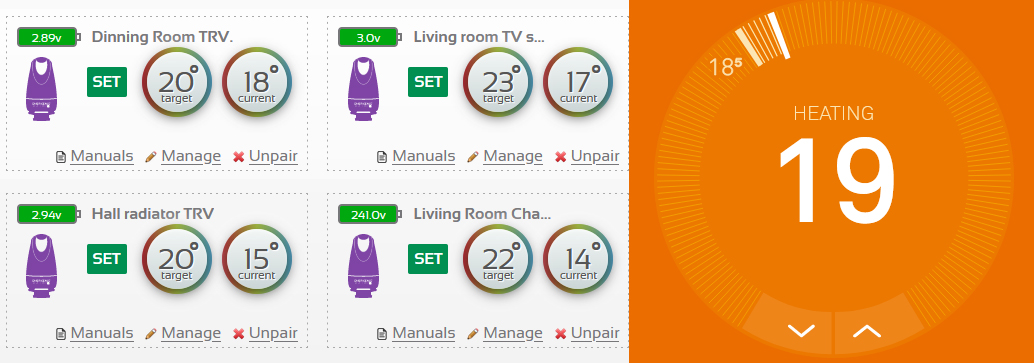

I have experienced a number of issues with rads being cold then warm on alternate days/times.
I balance the system and then the next day its out of balance once again.
On recording the data (rad temp in/out Dt etc) I concluded that this is a function of the ErP compliant system I have. It will increase/decrease the speed/hp of the pump according to flow/return temps at the boiler. Now this is a common feature on all boilers that are at least 5 years old so I can't be the only one to experience this.
So how do you experts balance a system that has variable pump speed/hp/flow rates?
