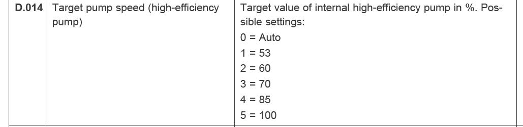

Got into the D codes & found the following info.
D005= 60C
D015 pump speed = 15%
D040= 54C
D041= 51C
Seems the wife changed the temp to 60C after watching a government add.
A pump speed of 15% seems very very low, pump head is proportional to speed squared, assuming a pump head of 7M at 100% then the present head is 7X0.15X0.15, 0.16M which wouldn't circulate any water, check that d.014 is set to 0 (Auto), one might think a setting of 3, 70% or ~ 3.4M would be more appropriate. Do you have a LLH (low loss header) or CCTs (close coupled Ts) ??.
Leave it on auto. That will give you the best chance of a lower return temperature. It will go much faster if needed.
15% is the signal power it gets, which won't equate to 15% rotational speed.
