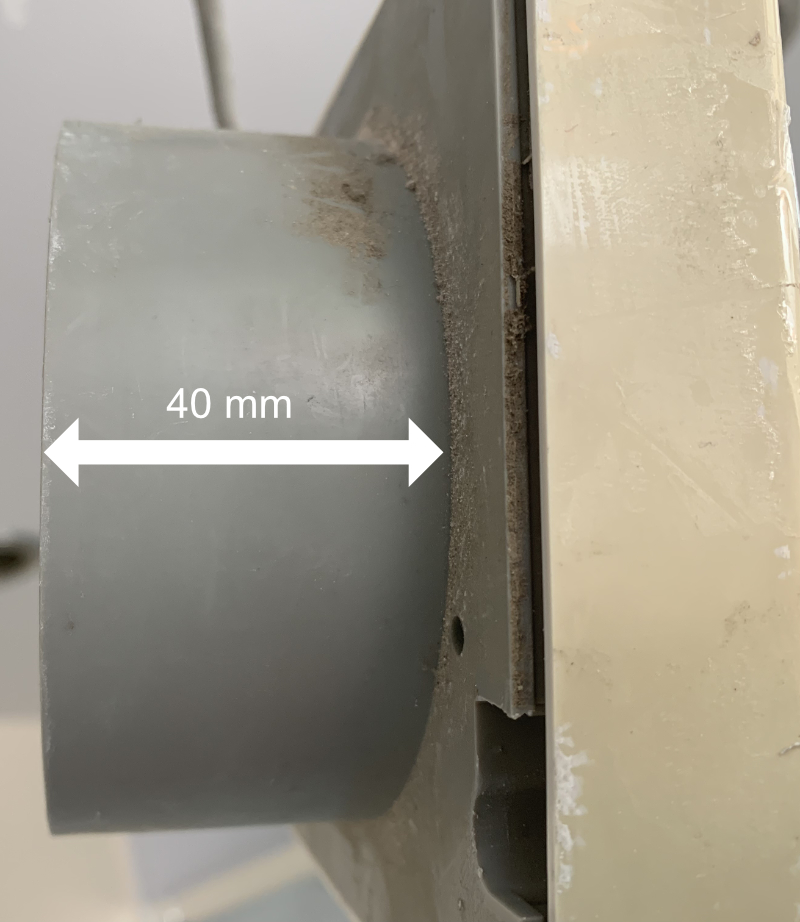

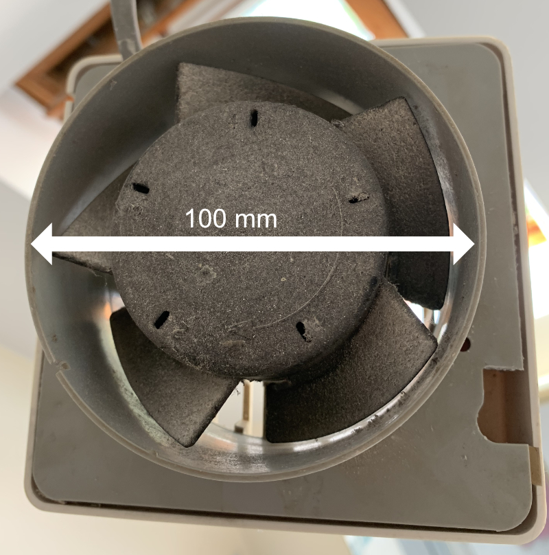

Do you instead measure the cylinder part on the back:
(image 2)
Or do you measure the side part of the cylinder on the back:
(image 3)

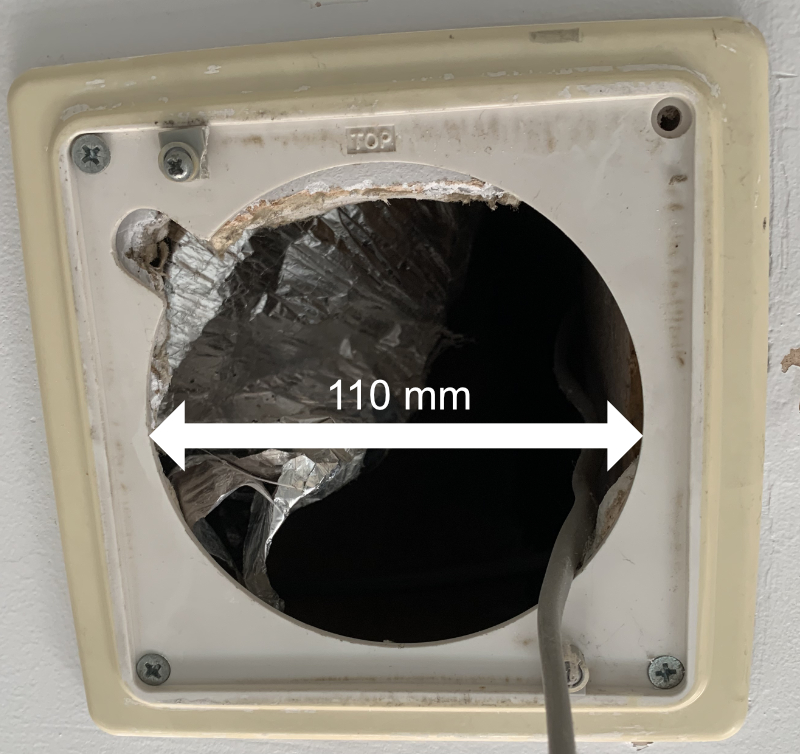

Or do you measure the circle part that is in the ceiling:
(image 4)
I think it is the cylinder part on the back (as shown in image 2) but I'd be grateful if someone could confirm.
I believe the 100/150mm refers to diameter of pipe to be using, so the one in your photo is 100mm.
