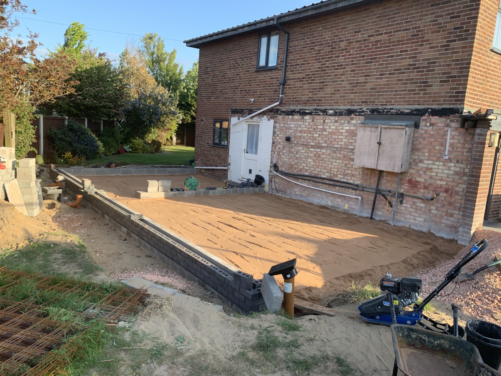

I’m doing the same myself now (extension with engineering blocks below dpc, blocks to be rendered above).
So far so good for me, but of course it depends on your competence to start with. I’m a reasonable DIYer and have done lots of research, watched YouTube videos, asked lots of questions on here.
I quite enjoy the challenge, and I know it won’t end up being as tidy as a profession job, but the render will hide most of my sins.
However, I am doing it through necessity - well it’s the only way I can afford to get the extension I want on my budget. If you can get and afford a decent bricklayer, then you’re in a different position to me.

I’m just at DPC level now, so hard to judge pace at this stage as I’ve had a lot of time levelling, measuring, etc to make sure I’m getting things right.
I’m also labouring and laying myself so that adds to the time requirement.
I’m of the mindset that it will take as long as it takes, but now the days are longer I can knock off work (from home) at 4pm and get a few hours in every night. (Yes my neighbours love me:))
Insulation, DPM and rebar to do this weekend. BC coming on Monday to hopefully sign-off before the concrete pour so fingers crossed I will be able to crack on...

I just practiced a few bricks with building sand and plasticiser, no cement. My first course is completely underground, and then I did the inner skin before the engineering bricks on the outside, so also got to practice on the job without too much fear of visibility.
For mine, like Woody said, from afar it looks alright. A bit messy close up, but I'm not sure anyone will look all that closely.
I think the key for getting it nice is a good mortar mix (not too wet or dry), and getting the quantity of mortar on the bed roughly right before you lay so you're not scraping off too much, or having to remove blocks to re-do your bed. I've bought some building profiles to help me from here-on-up, given it's 11 x 5.5m, it was a worthwhile investment for me.
