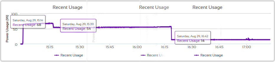

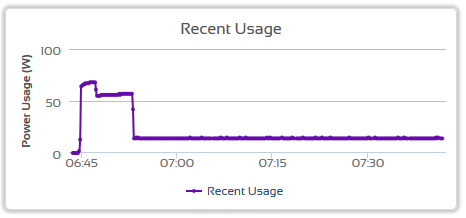

With a 90 Ah battery using a smart charger rated 3.8 amp likely it will only charge at 3.8 amp for ½ hour, after which it will charge at a lower rate, and with a 35 Ah battery using a smart charger rated 3.8 amp likely it will only charge at 3.8 amp for ¼ hour, after which it will charge at a lower rate, so the difference in charge time is ¼ hour between the two batteries.
This
is typical of the charge pattern from a battery charged with a smart charger, you will note a very short time being charged at 3.8 amp = approx 58 watts, the meter measures watts the charger is using, then slightly longer at 3 amp = 52 watts, with the charge rate at 0.8 amp = 12 watts not being completed, it would have in fullness of time dropped to 0.1 amp and finally off.
Because most of the time the charge rate is very low, time to charge is rather long, this is why lead acid is not suitable for most electric vehicles, it was OK for fork lifts, milk floats, mobility scooters all always recharged at their base and used for less than 8 hours a day. But for cars, push bikes, etc, what the battery both light as possible, and ability to fast charge.
The AGM or VRLA can charge faster than flooded, but to do so the vehicle has to map the battery and hold the battery at 90% charge for a week but then allow full charge once a week to prevent battery damage, so it can only be done with computer control and with a vehicle in regular use. My wife's car with stop start with the lock down has required the battery to be recharged with a smart charger as used so little.
The wife's car is not being used, so needs a charge this
Shows the first 3 hours, measuring input to charger so in watts, so starting at 12 volt so reasonably discharged, first 1½ hours put in around 6 Ah into a 90 Ah AGM battery, clearly very little, so now down to 0.8 amp charge rate, I would expect over night at least before it shows fully charged when charge rate drops to 0.1 amp, what you need to consider is how long would it take driving the car? I suspect a month, OK because wife has cancer and is not permitted to drive at moment it is not being used for rather a long time, have charged it once before during lock down, but 200 miles in 5 months is a very low mileage.
