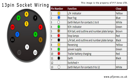

On a 13 pin there is more than one +ve supply. You should never have an issue with ATC regardless of charging battery or not.
Iirc there's Battery charging, Fridge pin (ours requires engine running and lights on) and Switched 12v for ATC?.

The wiring diagram you show is not to BS7671, one pin is for the brake warning lamp, can't of hand remember which, one of higher numbers, and you should not need to switch on head lights, BS7671 gives what pin is used, and cable min size, and states fridge and charging supplies should have independent live and return supplies, but not much else.
