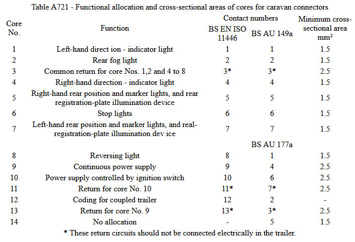

First the problems with charging a caravan battery from the car.
1) Reverse current flow from caravan to car when cranking, this is stopped by the Sterling B2B charger.
2) Volt drop from car to caravan, this is also stopped in the main with the Sterling B2B charger.
3) Discharging the cars battery, not quite sure how the Sterling B2B charger works with this, but likely is will stop over discharge of the cars battery.
4) Ensuring the fridge only uses 12 volt power when there is 12 volt power to spare. Likely the old voltage triggered split charging relay can do this, but first you need to look at caravan wiring.
So caravan wiring so from BS7671:2008 we have
done as a picture as wanted to keep in order, it also says
However you say no S plug so I will go into history, core 2 has over the years changed what it is used for, originally it was for caravan inertia light, then it was used for reversing light, and also a pressure switch on the vacuum or air tank, I always fused this wire in case the tow vehicle was used to tow a trailer with vacuum brakes, this is what it means by "coding for coupled trailer" (core 12) however it can today also be the anti-snake system.

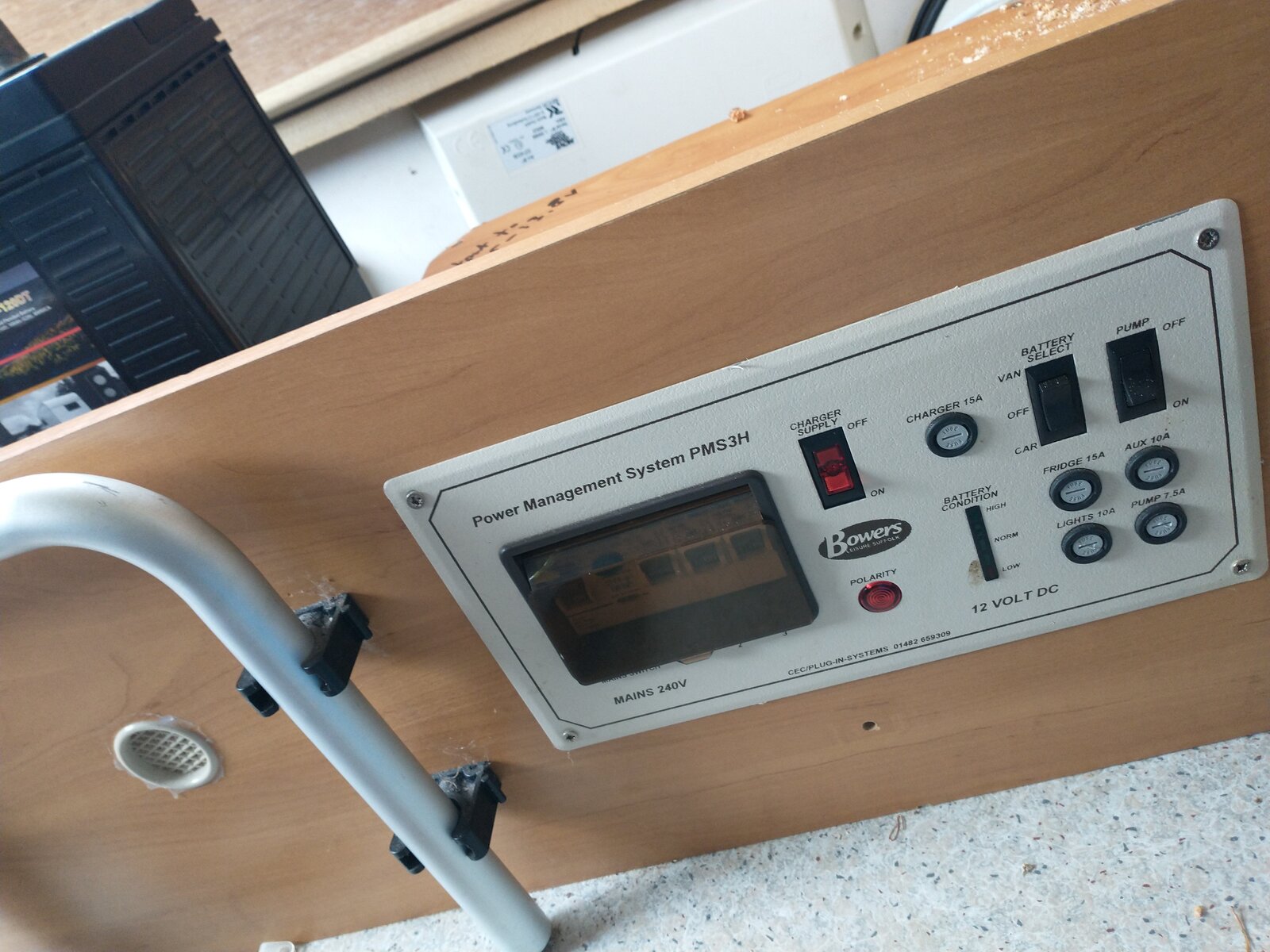

So I found it took some time to work out have the caravan was wired, there was a fuse box with relays, and it seems these have been updated over the years so finding exactly what it all did was not that easy, seem to remember there was one more fuse to labels on mine, at some time in the past the printed circuit board must have been changed, and a simple blown fuse was my main problem but it could get power from both sides, so it needed me to do a lot of looking up and testing to find how it all worked.
Some where I do have notes, but not on this PC, and until we know what you have rather pointless anyway.
