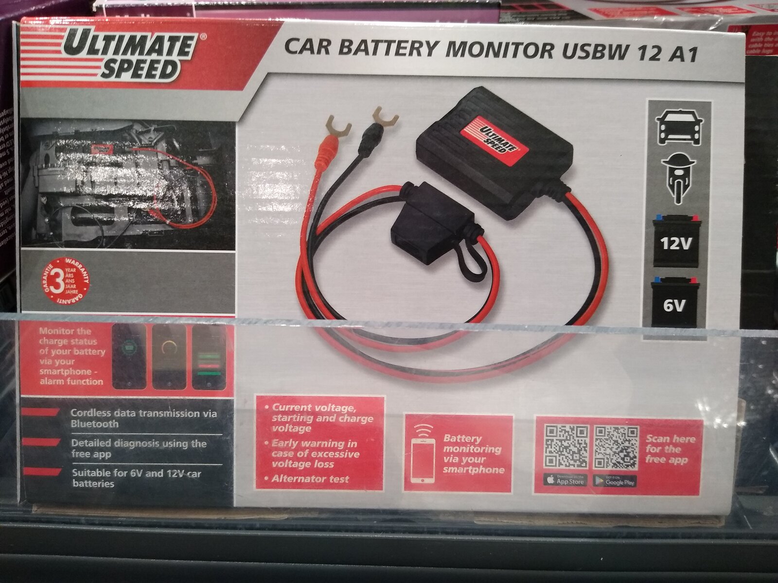

Saw this in Lidl today, £15. Might be a new toy for some of you!
