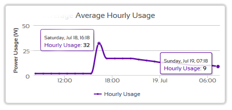

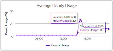

Well just fitted two new 35 Ah batteries into the mobility scooter, before fitting they were charged with Lidi charger as as said needs to be charged on the scooter once fitted, it would not get out of the drive, too steep, and the scooter volt meter dropped a fair bit, so put it on charge with scooters own charger
I have been surprised to see it take so much charge with new batteries which have only driven the scooter some 30 yards, it was showing 13.1 volts on Lidi charger both batteries in parallel at 4 watt, so now taking 4 times the charge it was taking with Lidi charger, I will test the scooter again tomorrow.

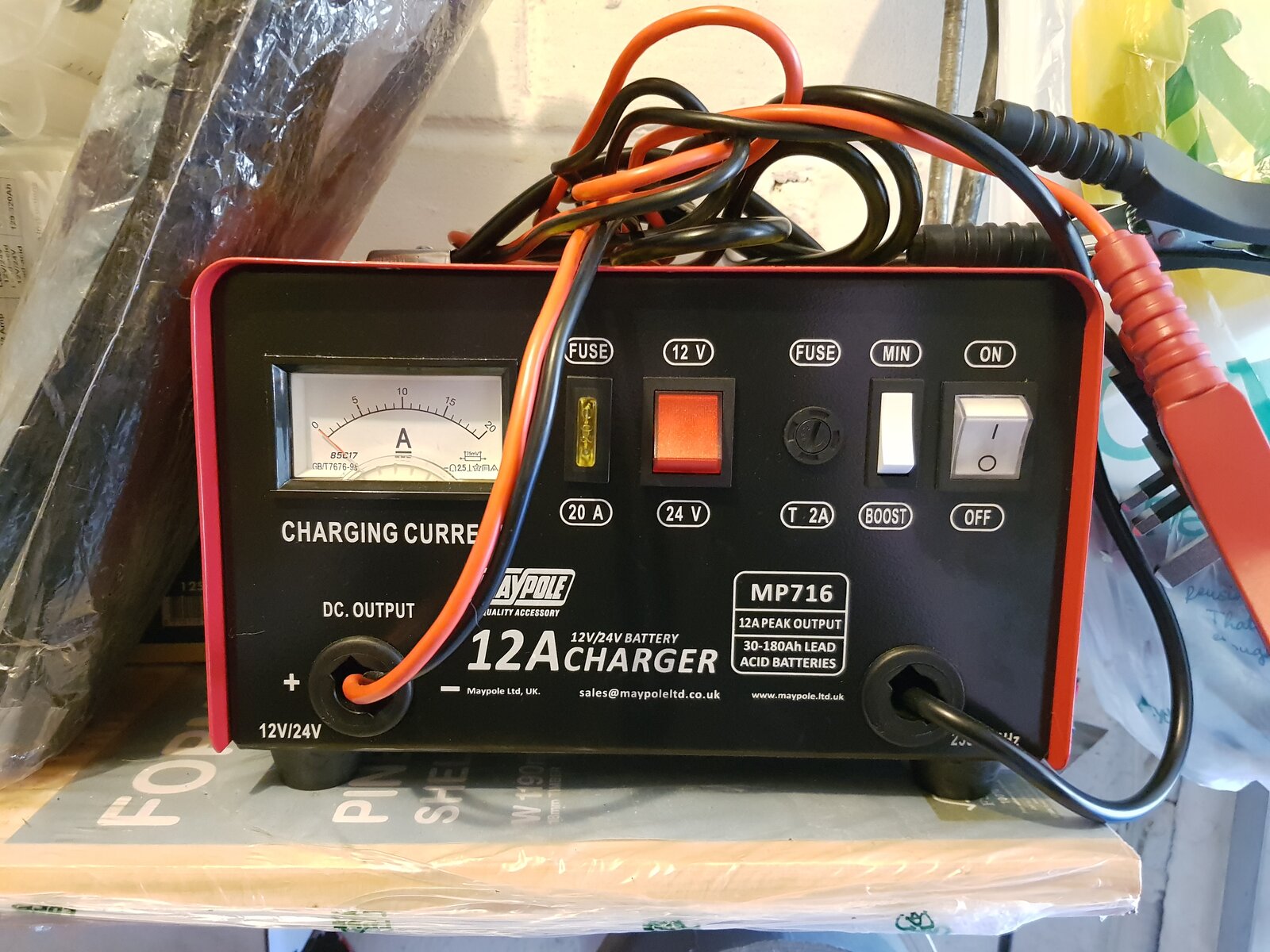

Instructions say
Maypole Metal Battery Charger MP716 said:
It is not recommended that a charging battery be left unattended for long periods or overnight.
A charging time of no more than10 hours is recommended, at no more than 10% of the battery’s ampere hour capacity. i.e. 60 Ah battery should be charged at no more than 6Ampsfor no more than 10 hours.
This product is suitable for charging 12V normal lead acid and AGM batteries of capacities between 20-90Ah(Ampere hours)only.
I think in real terms it is daft to have a charger which can't be left unattended for long periods or overnight, I will guess it is because it can charge at 12 amp which is a fair rate if the battery has a shorted cell, which is why I use the Lidi charger as it is such a low charge rate, it is unlikely to cause a problem even with a shorted cell.
The problem with a stage battery charger is the limited battery size, if battery too small it can be over charged, but the same also applies if the battery is too big, as the current will not drop low enough for it to drop into final stage.
At £48 new the charger you show is quite cheap for a 12 amp charger, they are normally around the £80 so would assume it is not a stage charger, I would have no qualms at using to recharge a car AGM battery for 8 hours if completely discharged, or a flooded for weeks, as the latter can be topped up, but it does need monitoring, at least twice a day, where the likes of the ctek and Lidi chargers don't need that daily monitoring.
Me too, it is a lot of potential heat that 12amps can generate in a battery with a shorted cell. If I intended leaving it charging unattended for any length of time, then I would want to make sure the charge current fell to a very low safe value first.

Yesterday evening, with a bit of time to kill - I went searching for information on maintaining such batteries. Varta's battery site seems to be offering some sensible reading, without getting too technical. It agrees with me that batteries should never be left on a permanent charge. It says that recharge requires 1.25 times the amp/hour of the amp/discharge - so if you discharge a battery by 10amp/hour, it will need 10x1.25 = 12.5amp/hour to replace that discharge.
After an over night charge
it seems reasonably clear the battery was not charged in the first place, now the Lidi charger has three options
for batteries less than 14 Ah,
for batteries 14 to 120 Ah, and
"12 V" (14.7 V / 3.8 A) For charging 12 V batteries with a capacity of between 14 Ah–120 Ah under cold conditions or for charging AGM batteries. There is also a 6 volt option but that is not user selected.
It seems the voltage raise 14.4 to 14.7 is required for AGM batteries.
