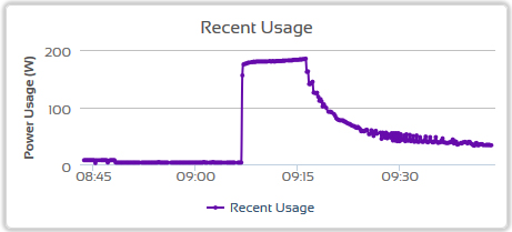

I wonder how long those replacement batteries had been in stock before I bought them, got them direct from manufacturer so would hope not long, but clearly were not fully charged and even now 9 watt seems a lot for two AGM batteries if fully charged so maybe still not charged. Although 9 watt = 375 mA so not really much of a charge.
