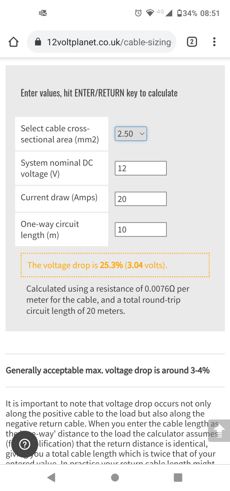

Thanks. That's the theory but it's well documented that the voltage drop on 10m of 2.5mm cable is quite considerable, hence the market for alternative setups (very common in Australia and the States, not so much here where people just plug in). We tour/camp off grid for weeks at a time so need an effective charging system, not least because when we get home we have a fairly torturous uphill route to park the caravan which means the motor mover pretty much drains a fully charged 110amp battery.

Sorry, but you are wrong. 2.5mm is absolutely fine for the 20amp of current, but as this is only 12v volts drop is considerable and often ignored by manufacturers and installers. I installed 2x 4mm end to end of my towcar, to overcome the volts drop and make sure there was enough volts at the caravan to run the fridge and charge the battery.

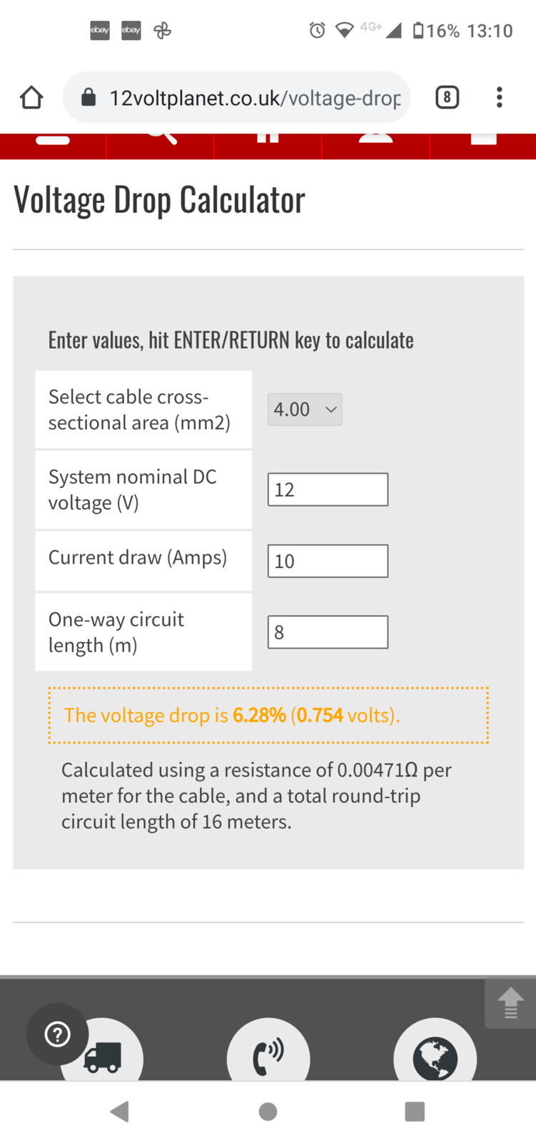

I certainly don't have the knowledge to argue with anyone on this and I don't know how long your cables are but my calculator tells me there will be a fair drop which may result in a less than optimum charging voltage. I don't have a clue what range of voltage the fridge element tolerates.

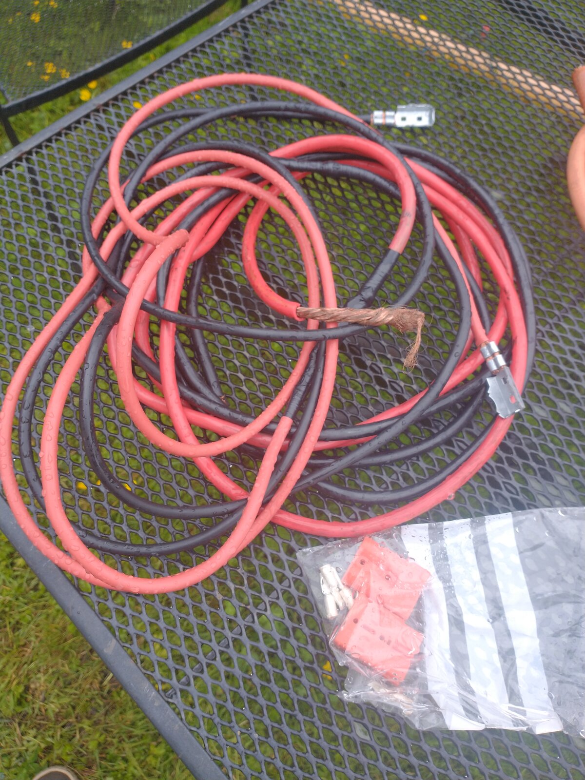

My cables are probably oversized but they're just recycled jump leads so cost me practically nothing:
The calculator confirms that even a single 4mm is not adequate, if you assume 14.2v at the car battery, less the 0.754 drop, that means 13.44v available at the leisure battery - not enough volts to charge it effectively.
