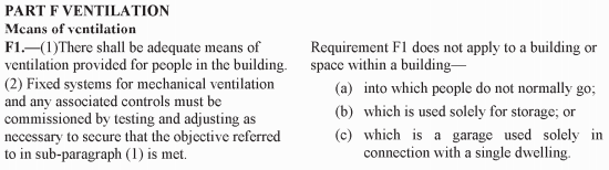

Well…there is an awful lot on BR Part F.

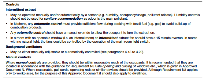

The fan bit is all over the place. In particular to this, Part F basically says
For toilets only, ‘purge ventilation’ (an opening window/door on an external wall) meeting the requirements specified in Appendix 2 of ‘Approved Document F - Ventilation’ can instead be used to provide ventilation if security is not an issue. If this is not available then purge ventilation by one of the approved methods (a fan) is necessary.

I note this is basic what the planning portal approved documents say, seems to make a big thing about noise of fans, and suggests heat recovery units.
That's it.
Edit - there are some bits about notices as well.

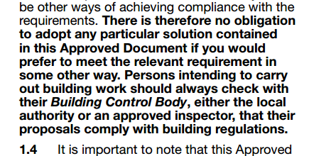

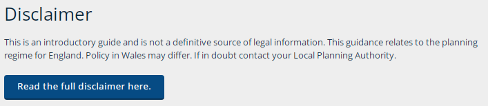

From The Planning Portal, if the same as mentioned by Eric:

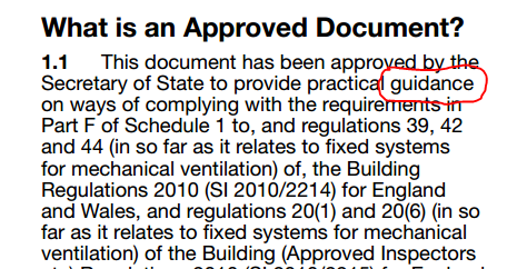

and The Approved Document F (and all the others),
only the parts in shaded green are the actual Regulations:
