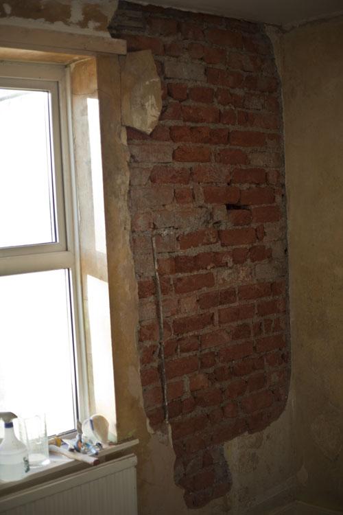

Hello all,
I recently moved into a Victorian terrace property which required a little patching up. After purchasing the property we asked a local damp expert to come round and give us some advice. In one of the bedrooms he found some slight damp adjacent to the window in the external wall. This room is intended to be a nursery for our 5 month old boy, so we felt it was important to sort out any damp problems before renovating the room (and indeed after removing all the wallpaper there was fungus/mould on the plaster around the affected area - roughly 2 square meters)
His advice was to strip back the plaster and leave the brickwork to dry, then replaster. At the same time, rectify the source of the damp, which is some cracks in the external cement rendering near to the window.
The stage I am at is that I have removed all of the plaster from the area, except from the render directly around the window. The brickwork is pretty crumbly, but is sound. The masonary doesn't 'feel' damp, but the surface of the bricks is soft and can be scraped off with a fingernail.
I am waiting for a spell of sunny weather (some hope...!!) to patch up the cracks in the external wall, but once this is done how long should I wait to dry out the brickwork?
How do I tell when it is ready for replastering? As I say the bricks don't actually feel damp, so is there something I should look out for or a test I can carry out?
I have also read on this forum that there is no real need to repoint the brickwork if it is going to be replastered. But does this apply to an area affected by damp? I attach a photo of the room, and advice is greatly appreciated on how to proceed with this project.
One last question... there is a piece of what looks like a pipe under the plaster (you can see this in the photo - a vertical line towards the bottom of the brickwork). When I was first removing the plaster I thought this was an electricity cable, but it is metal and quite flexible (lead) but goes nowhere, it just comes out of the lower section of plaster towards the floorboards and stops half way up the wall. Any ideas what this could be?
Regards
Tom
What did your damp 'expert' get out of it?
It's the outside you need to look at, not fart about hacking walls to bits.
Check the guttering.
If possible post some pictures of the outside of the window, wall and guttering.
Andy
iv done same repairs as your problem , as you have an old property there should have been an air vent in the room it will stop the damp and mold forming if air is in the room , also like the other quote you have recived , it is more or less due to leaky gutter or somthing out side building , if you want to get the wall dry hire a dehumfier and it will suck up the damp from the wall , its an old wives tale to be told that you will have to wait for sunny weather , and the way things are with the wetest june on record , you are going to have a long wait, check out side for where any water may be comming from . repair with lime sand cement render and this will help the building settel better in this area of the dammage as cement and sand does not agree with old buildings and you will get a better result as less likly to crack when dry , then you can multi finish plaster skim after wall has dryed out , should not take more then a few days to dry at the most . if any one plastered with bonding plaster when they put windows in it will draw the damp through the wall on an out side wall , only hard wall or lime render should be used to repair this.

You are going about this the complete opposite way to what you should. You are treating the symptoms of a problem and not the cause.
Why do you have damp in the house? Why is your render failing on the outside?
Check your gutters and roof before you do anything else - THAT is where the problem lies.
I am treating both!
I have already said what the problem is, there are cracks in the external render adjacent to the window where the water is seeping in. I can't get access at the moment to take a photo, but I will post one when I can.

Even though it's always best to look at gutters etc It would seem clear cut to me. The problem will be the cracks on the external render allowing water to penetrate.
I would suspect the render is sand and cement.? If so I would remove the lot and re-render it using lime render.
Is it a solid wall construct, or do you have cavity walls?
I would also remove the soft decayed brick and replace.

if you have a cavity wall and craked render then the issue is not the render !
if you have a solid wall and cracked render then the issue is the render

Nah we don't get enough rain to go through 9 inches of brick. The render is cracking because water from above is getting behind it. If you look at a house in the rain it hardly gets the walls wet - that's what the roof is for.
