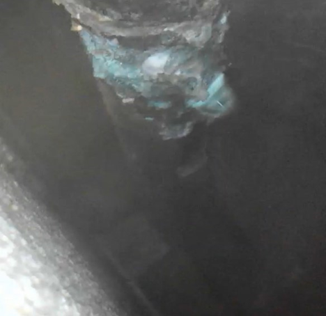

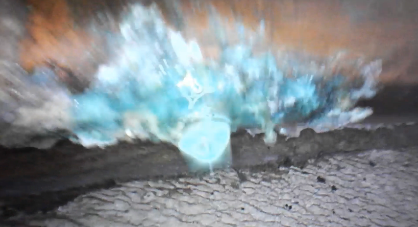

For what its worth, I managed to get an endoscope camera to locate the leak - fiddley but got there in the end. It's on a 60 year old soldered joint on a disused hot water feed to a basin removed 30 years ago when we last did the bathroom. We're "lucky" with the location - it is within a tiled boxed vertical riser (? - column) that provides water services to each floor, but it is behind a cistern, so the access damage will be easy to cover. Just have to hope those rusty screw holding the cistern to boxed column come lose easily and that the cistern does not break in the removal process.
Not the screws yet, but this is what I found. Link is to the video

Leak addressed.
The old vent for the gravity system was also part of the hot water supply system and the leaky joint was from work I had done 30 years ago. It was under perhaps 2 or 3 feet of head until it became part of the unvented system (ie the open end was capped off).
Rather than risk breaking the toilet cistern and cutting into the tiles, we figured a way of making it obsolete by various changes to pipework under the floor - the same floorboards that were last up in 1991.
