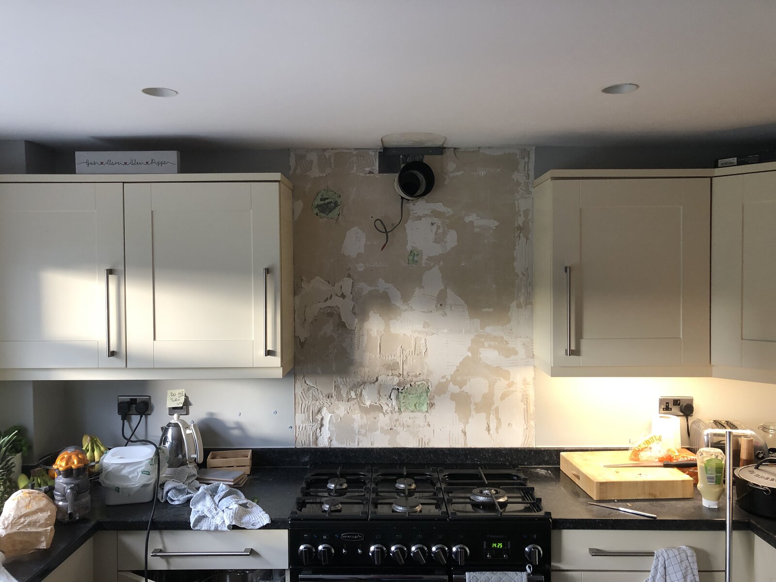

Thanks for the info. I've started re-tiling the splash-back in the kitchen below the bathroom. When I've taken off the old tiles I can see the power cable to the kitchen extractor that comes from a fused spur. Can I use a WagoBox to run a 2.5mm wire from this cable, to a fused spur above the cabinets, which then supplies the heated floor in the bathroom above?

Is 250 watts for the amp the audio output or the power input? If the amp is for the kitchen I'd probably put it on the kitchen fan circuit, but not if it's elsewhere.
Definately not the underfloor heating on a lighting circuit, and I'd be reticent about putting it on kitchen fan spur either.
