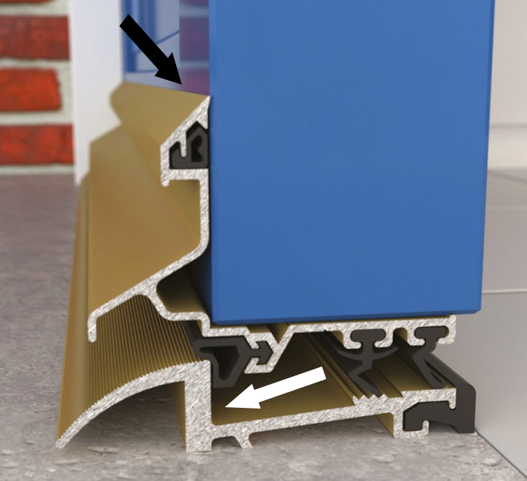

Here's the situation, sorry for longish post! Door is fitted with this:
It's not been fitted well in the first place and is letting water in when there's driving rain. However the water doesn't appear to be getting in at the opening (handle) end and/or the hinge end, it's getting in more towards the middle. Given the design of the weather bar I can't get my head around HOW the water is tracking through and in. If you look at the side view image below, you will see the section that attaches to the door is one piece, it runs from the outer face to the underside. I've ran a small bead of sealant where you see the black arrow just in case water was finding its way in there. Hasn't fixed it.

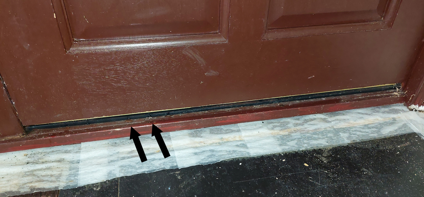

If you look at the arrows on the other image (actual pic of the door), these indicate where the water appears to be dripping through. If you run your finger along the top of that inner seal, it's wet. I ended up taking the two inner seals off today to further investigate and when I ran my finger along the underside of the weather bar (underneath the door), it was wet ... but not at either end, further in as per the arrows. The bottom of the door is also getting wet. I know this because I recently shaved the door end (handle side) and the bare wood is wet at the bottom 2-3 inches.
I'm perplexed. From what I can see, the outer seal is engaging properly with the threshold when the door is closed. So, given the one piece design, how the heck is water a) getting in and b) tracking across those seals to the inside?

Water is accumulating on the highest gasket. Since the water can't be made to disappear by magic. it seeps downwards to the bottom of the door and comes out between the door and the fitting. You need a bead of sealant at the highest part of the fitting to prevent water reaching the top-most gasket.

But what I don't get is I've sealed the external high point, see black arrow on first pic. Used Dow 791 and ensured the top edge was properly sealed.
I'll check it again tomorrow in case there's still a gap.

tbh that's not really the issue. There are drainage holes and they're not blocked. Sometimes when I open the door there is zero water in there (i.e. the threshold bit you step over), sometimes one or two small pools but very small and they're at the drainage hole side if that makes sense i.e. not over towards the inside. Regardless of whether there's water in there or not, water is getting inside the property and it appears to be dripping from further up i.e. between the bottom/underside of the door and the metal plate of the weather bar.
This is what's now confusing me as I've sealed the top edge of the weather bar outside where, as suggested by diynutjob, water's maybe getting in and being stopped by that upper seal and therefore seeping through the actual door and dripping out the bottom.

The sides of the fitting are exposed. Water could be getting in from there. Take a picture of the sealant you applied on the top edge. If properly done, it should not be leaking from the top. You mentioned drain holes. Is water getting in from those?

Bear in mind the first pic (side view) is off the internet, it's not my install. However you're nevertheless right, one end of the weather bar is (or was) exposed as one of the end caps must have fallen off. I've filled that however as with the top will re-check.

Given that it’s an open in door, the external door drip part must be cut in between the frame with a tolerance gap - it’s entirely possible water is running down the door - wind will encourage it to go to one side, and then running along the extrusion between metal and door along the extrusion.
if it was me I’d get a hose or watering can and run first down one edge of the door, check, then do other side, check, then do the middle
