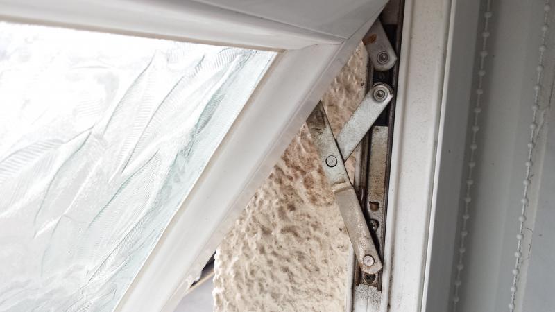

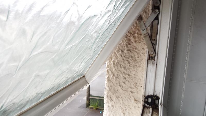

How to adjust (tighten) a window?

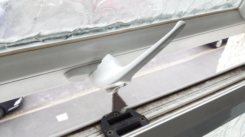

Unfortunately not, from those photos it looks like its a 'saracen' make of locking system, should say on that centre black plastic frame keep, think the only course of action would be to replace the white gasket for a slightly thicker one
Can't see 'Saracen' anywhere (but that doesn't mean it isn't there). I was thinking of changing the seal. At the moment I have double plastic coated foam seals ie one on the window and one on the frame. This is about 6mm and the thickest one I can find on FleaBay is this
http://www.ebay.co.uk/itm/R667992W-...727?pt=LH_DefaultDomain_3&hash=item4d04f3071f
it's 5.5mm thick.
Are there other variants available?
Cheers
