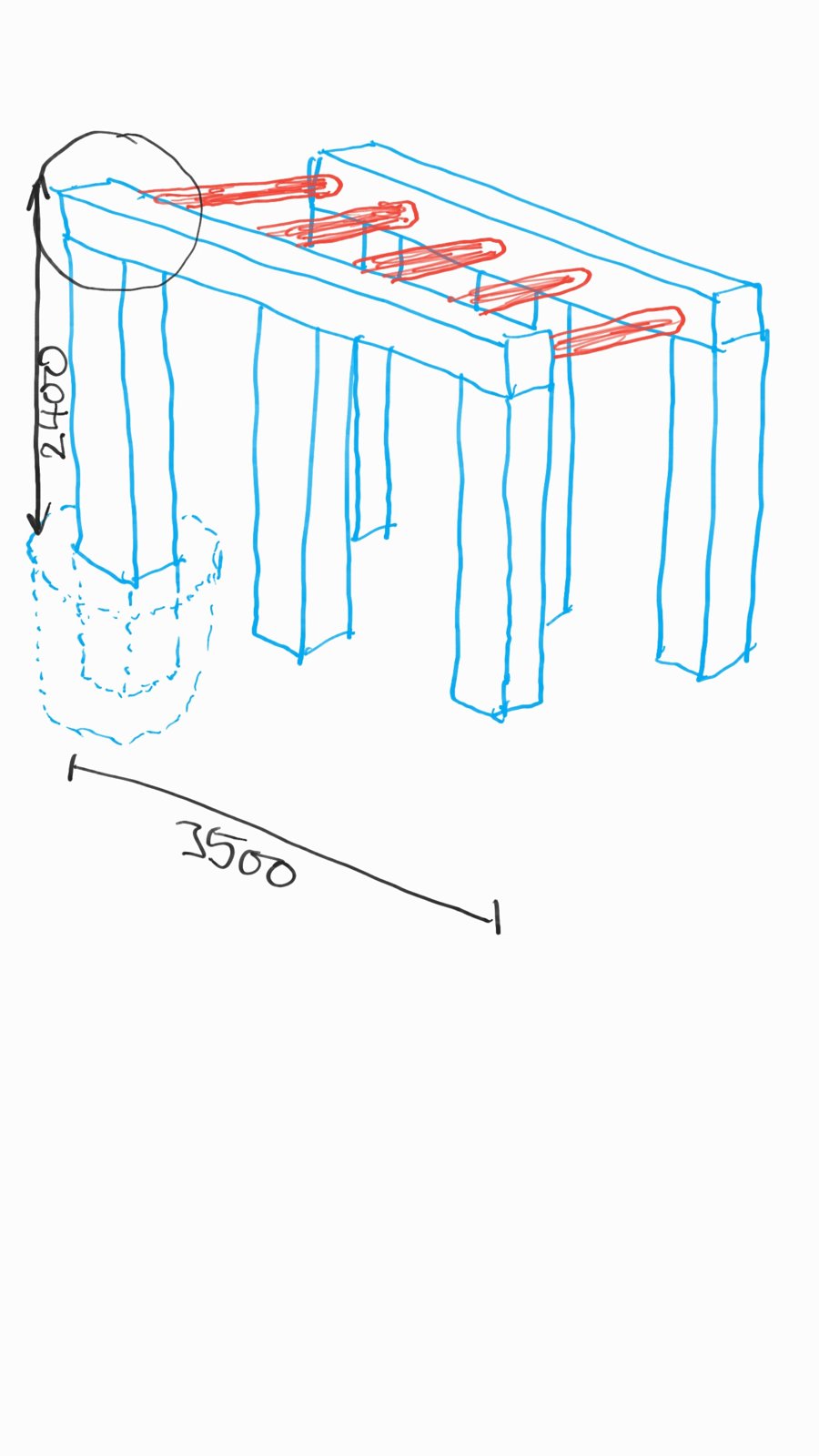

Want to build a monkey bar frame for my friends kids.
Here is the design:
Basically just wondering if my design is strong enough. Although the 4 inch posts are buried 600mm in the ground with postcrete. I figure if fence posts can work loose then surely with kids swinging on it, it might start to work the posts loose over time and get some lateral movement without the proper restraint. The kids are only young, but even so.
Currently I've just got the horizontal and vertical posts butt jointed, tied together with Timberloks as circled in the image, but not sure this will resist lateral movement. Trying to avoid diagonal braces, and a lot of the designs online don't seem to use them.
Could I get away with a bridle joint in each corner, or is it strong enough as is?
You normally put a third of the post above ground into the ground
So in your case you have 2.4m above ground so you should have 800 mm below ground
Bridle joints won't hurt for your peace of mind
Certainly a solid set of monkey bars!
