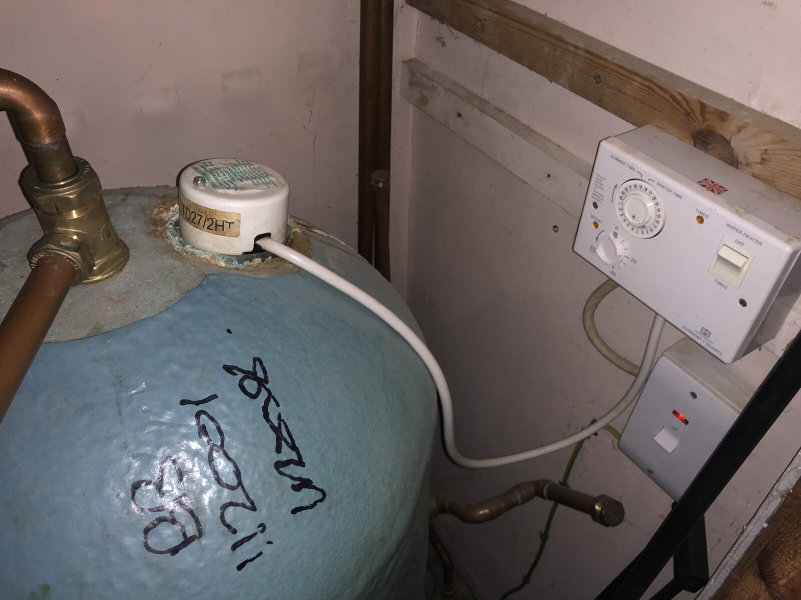

Hello all,
Just a quick question. I am currently remodelling my bathroom and I would like my immersion heater to now be running all of the time so I have access to how water whenever I want it, whereas at the moment it runs on a timer and heats up on the Economy 7 tariff overnight.
My question is how do I achieve this? Currently everything is fed by a 20A double pole switch, which then has a flex running into a timer and then a flex from there into the top of the immersion heater. I have included pictures below of what is currently there. The plumber who worked in my bathroom mentioned that I would need something like this https://www.thefloorheatingwarehous...MIi5Xqv7ux8wIVi7TtCh22CgOWEAQYASABEgK16PD_BwE and this
https://www.bes.co.uk/cylinder-thermostat-20007/ but is this necessary?
Many thanks for any help.
Edit: Just for clarification, I am an electrician and can carry out this work. I predominantly work in the industrial sector and have zero experience of heating systems, however.

A 13a plug will cause the immersion heating to run all the time.
To give a serious suggestion, I would try and simpler method than the wiring centre on the basis it’s only for hot water.
do you occupy the house all day? Do you have showers and do your washing up at regular times?
I would check your immersion Rod has a thermal cut out. Might even be worth replacing it for good measure as they tend to corrode over time anyway.
Do away with the programmer.
Replace your double pole switched fused spur with a Digital time clock double pole spur.
Time guard do a 7 day one. Just set it up for the hours you require water. for example 11pm-5am you could have it off. Turn back on at 5am so it’s warm for a 6am shower. Leave it on till everyone in the house is up and ready for the day. Turn it off during the day while your out. And then have it turn back on an hour before your all home and run it up till 11pm
weekends you can set a different time period.
hope this suggestion helps, I used to be a domestic electrician but I’ve myself been on commercial and industrial projects for a while.
please correct me anyone who see’s a better method

Further. If your current double pole spur is supplied on an economy 7 circuit it will be isolated all day. I suggest you make sure it’s on a normal feed on your main consumer unit

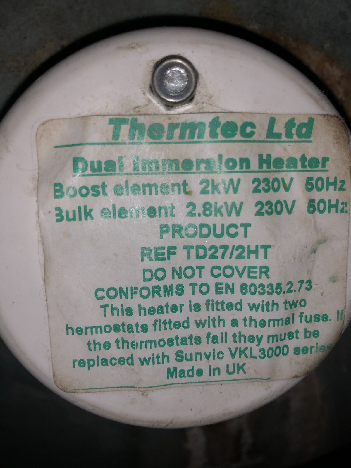

Looks like a dual element immersion, which has a long element for economy 7, and a shorter one to boost. Need to check both are functioning

Thank you very much for your response. This is probably a better idea than having it running all day. I’d just like the option of having a shower after work, which I currently need to use the ‘boost’ function for.
Additionally, the timer is old and noisy so there’s another reason to replace it.

The programmable switched fused spur time guard do allows you to have it turn itself off and on multiple times during a 24 hour period, just set it an hour before you will require it. I.e mornings and evenings. The rest of the time it can be switched off 4:30am-9am on. Then off till 4pm, back on 4pm till 11pm to cover washing up and after work baths / showers. Back off again till 4:30am

I was thinking this before I got the plumber’s advice, which threw me off as it seemed excessive but I thought I’d check with people with experience of this sort of thing before I changed anything.
I think I’m going to do that for now and then change to a more modern control in the near future. This thread has been extremely helpful though, so thanks to everyone for their input.
