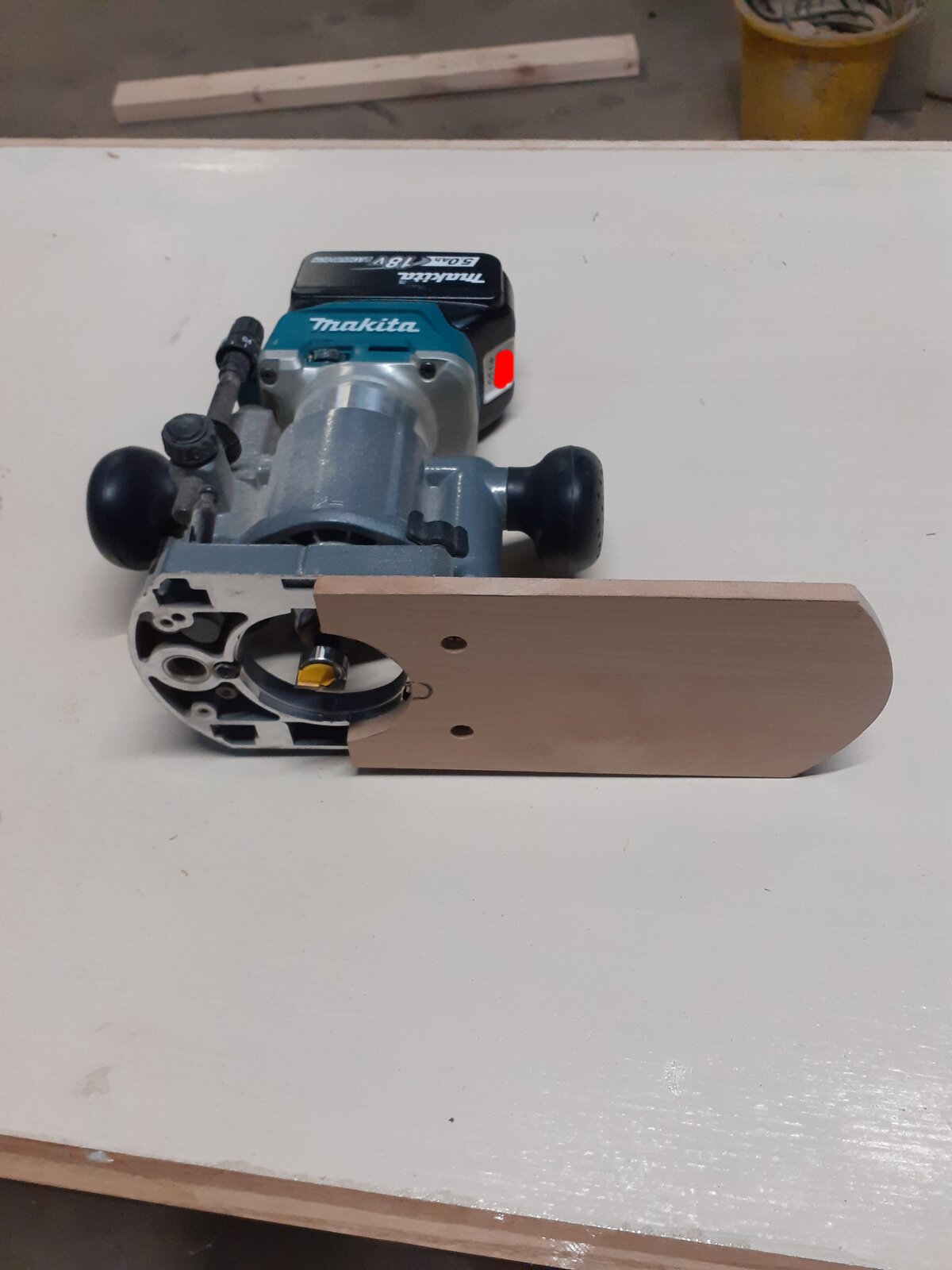

By "melamine" °I presume you mean melamine faced chipboard (MFC). Laminate trimmer (or trim router as they are often cslled) and a bottom bearing trimming cutter, preferably 12mm or more in diameter as small diameter bits tend to dig in. Lippings should ideally be ripped down so that they are no more than 4 or 5mm wider than the top is thick (so for an 18mm thick top, 22 to 23mm wide). This technique works best with a body grip tool and thin (i.e 6mm or less) lippings - thicker lippings really call for the second technique below
The alternative is to make up a half sub base or offset sub base to replace the standard sub base of a conventional router and use a larger diameter cutter to take the lipping down to within 0.5mm or so of the main surface (NOT flush as that would risk digging in to the surface of the MFC), then finish carefully with a very sharp block plane with the mouth set really fine. I generally use a 16mm or larger diameter cutter when doing this, as in the attached photos. This technique works well with thicker lippings such as the door lipping shown below
For the technically inclined the plunge router is a Makita DRT50 cordless laminate trimmer motor mounted in a Katsu plunge base. Any small (i.e 1/4in) router with a fine depth adjuster, as opposed to a plunge, plain depth rod and turret adjustment, would suffice. The sub base was made up from a scrap offcut 8mm MFC - 6/8mm plywood, MDF or similar would suffice The only reason a cordless tool was in use is because I am trade and that was an on-site job making up special tall bifold doors with hardwood lippings

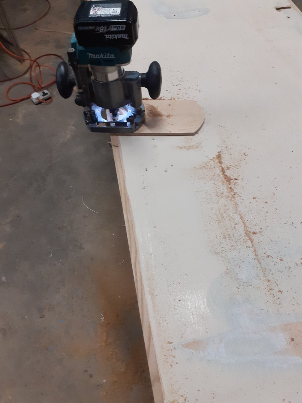

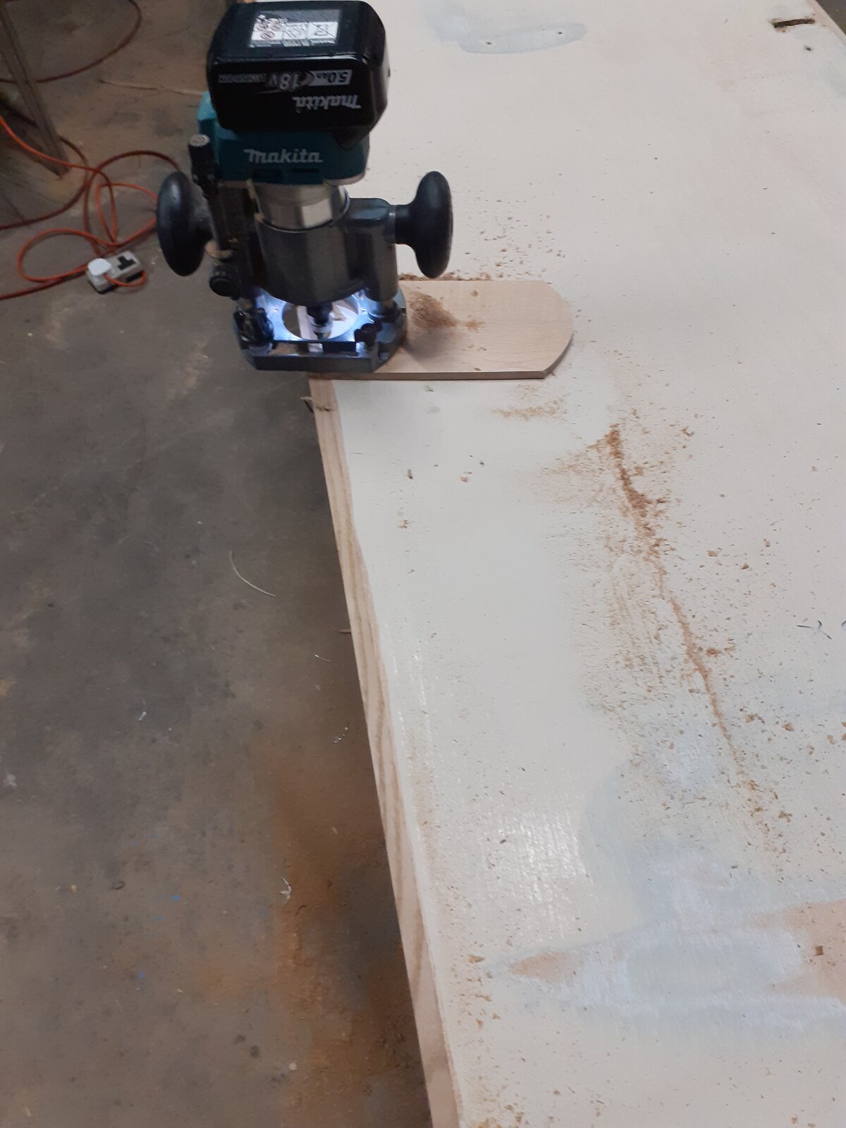

And if I understand it right, your second picture shows you routing the lipping in advance of finishing with the block plane?

Then you will really need to make up a lipping sub base, as above (20 minutes work). This is because the cutter needs to project below the router base but be slightly above the level of the bottom of the lipping sub base. Look carefully at the photos I posted and it should be possible to figure out why (I hope). If not I'll do an explantory sketch and post that, just ask. The router and trim bit only works up to about 5 or 6mm lipping thickness, because you are running the router on the edge of the material which greatly increases the potential to tip the router and ruin the workpiece. The bigger and heavier the router the more likely it is that you will have at least one tiipping incident. That's why for running along the edges a small, lightweight laminate trimmer Is preferable - but the thickness of the lipping in that case shouldn't exceed 5 or 6mm (ideally 3mm or less) with only a couple of millimetres of overhang.
Yes. In that case the door I was lipping was already painted and I stopped the router mid cut. The cutter was set so fine that it removed some of the paint from the door (so maybe 0.2mm or so above thr door surface) but it didn't go through the face veneer (fortunately) requiring only one pass of the block plane and a touch with the sander to finish it ready for the painter
How did you attach the lipping - glue?
Yes. D4 "PVA" (Everbuild D4 wood adhesive). Coated both surfaces, clamped using 2 x 2in CLS for csuls and a clamp every 2 or so. If you don't have enough clamps you canmake some temporary ones up using 2 x.1in PAR softwood and screws. If unsure, just ask again

Oversizing probably makes it worse because you are trying to run a full size base on a narrow (often 18mm wide) edge. That is part of the reason why laminate trimmers are so small. Oversize baseplates are more commonly used to deal with situations where you need the router to span a large void, e.g. relief carving
There are fundamentally only three ways to trim a lipping or edging with portable tools - use a physically small router running on the edge of the
material with either a bottom bearing guided trim cutter or a straight cutter and a follow bearing arm assembly (generally only useful for thinner edgings/lippings), use a conventional router with a straight cutter and an offset sub base (as above), or buy s specialist edge lippingbtool such as the Festool MKF700 which are designed to run with a horizontal plate and motor (and which are an expensive limited option)

Yes I understand now, thank you. The lipping sub base is there to reduce the likelihood of the router tipping into the wood as you manoeuvre it delicately along the edge, because there's more of it on the body of the door/desk, which allows more stability.
