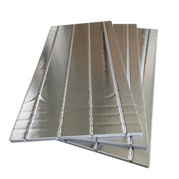

The system will look like this - exact model not shown but it is the prefabricated insulated boards with pre-routed pipe runs.

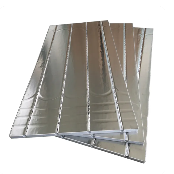

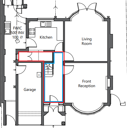

I'm not able to provide a picture of the hall at present but hopefully the following plan will help.
The area marked out in red is a solid floor, as is the garage but that is slightly lower down (1 course of bricks).
The area marked in blue is the proposed area to lower.
All other floors are suspended.
The mark up of the floor at present is wooden blocks on a bitumen base, underneath that is concrete.
The front door threshold is currently around 15-20mm above the current wooden blocks.
The system I am looking at has 18mm ceramic "planks" that go above the pre-formed sheets shown above that the pipe sit in, and then the final floor covering on top which will be ceramic tile.
One reason for choosing this system with the ceramic sub floor is that if I have any difference in floor heights between the rooms (likely) I can put a few mm of liquid screed on top of the lower floor to get them level, or potentially loose it in the top ceramic tile adhesive.
I can dig down further and put in more insulation but need to understand the make up of the floor after I have dug down. And, if there is an easy way for me to level that surface with minimal building knowledge before putting something on top.

The pre-formed UFH sheets
The 18mm ceramic floor planks that are part of the system.
