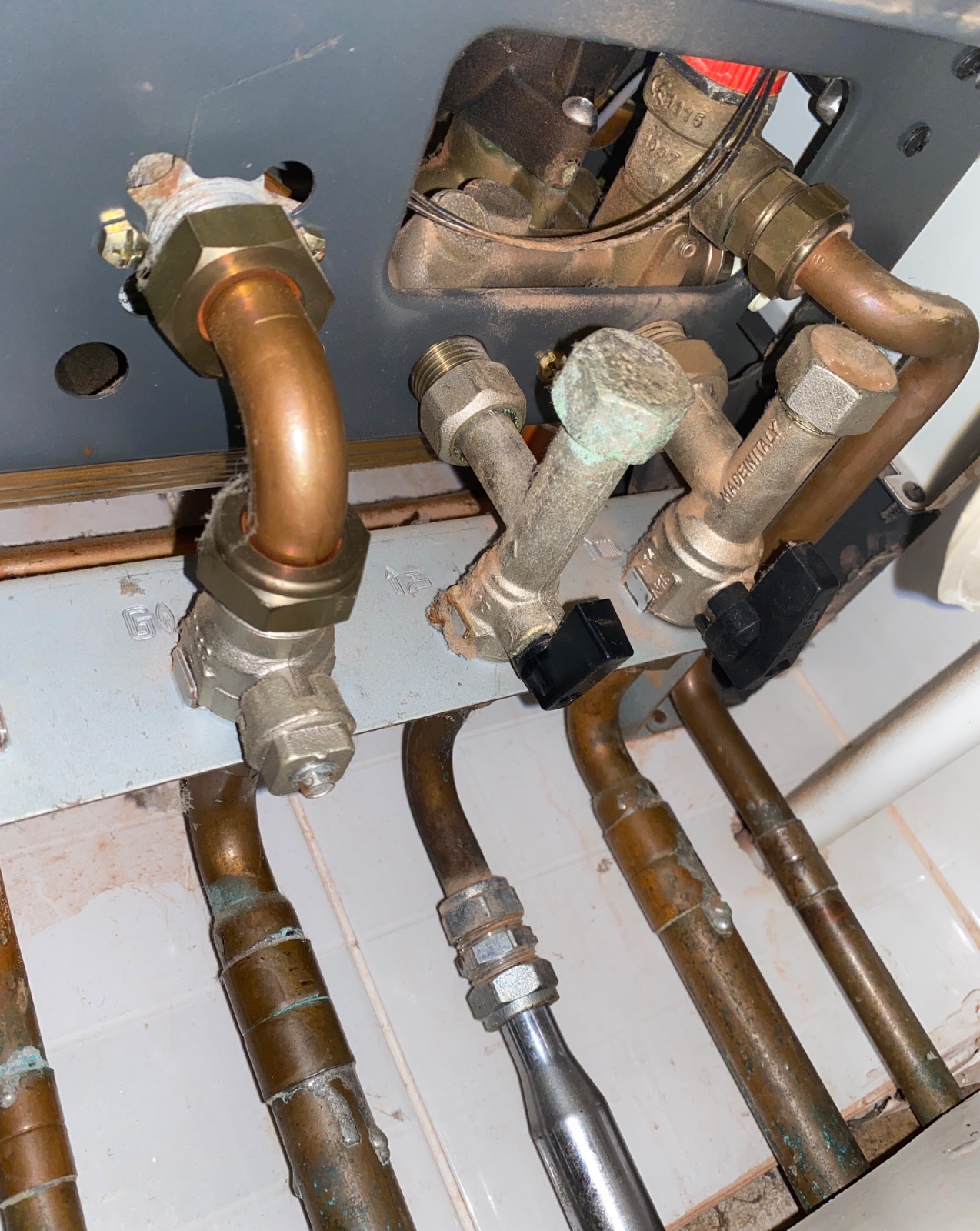

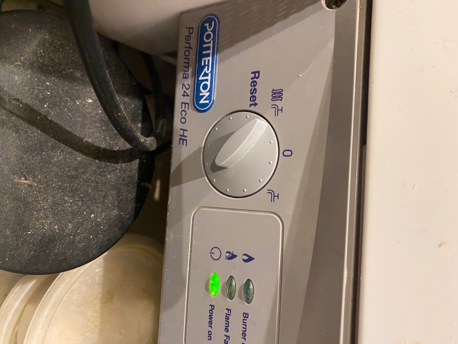

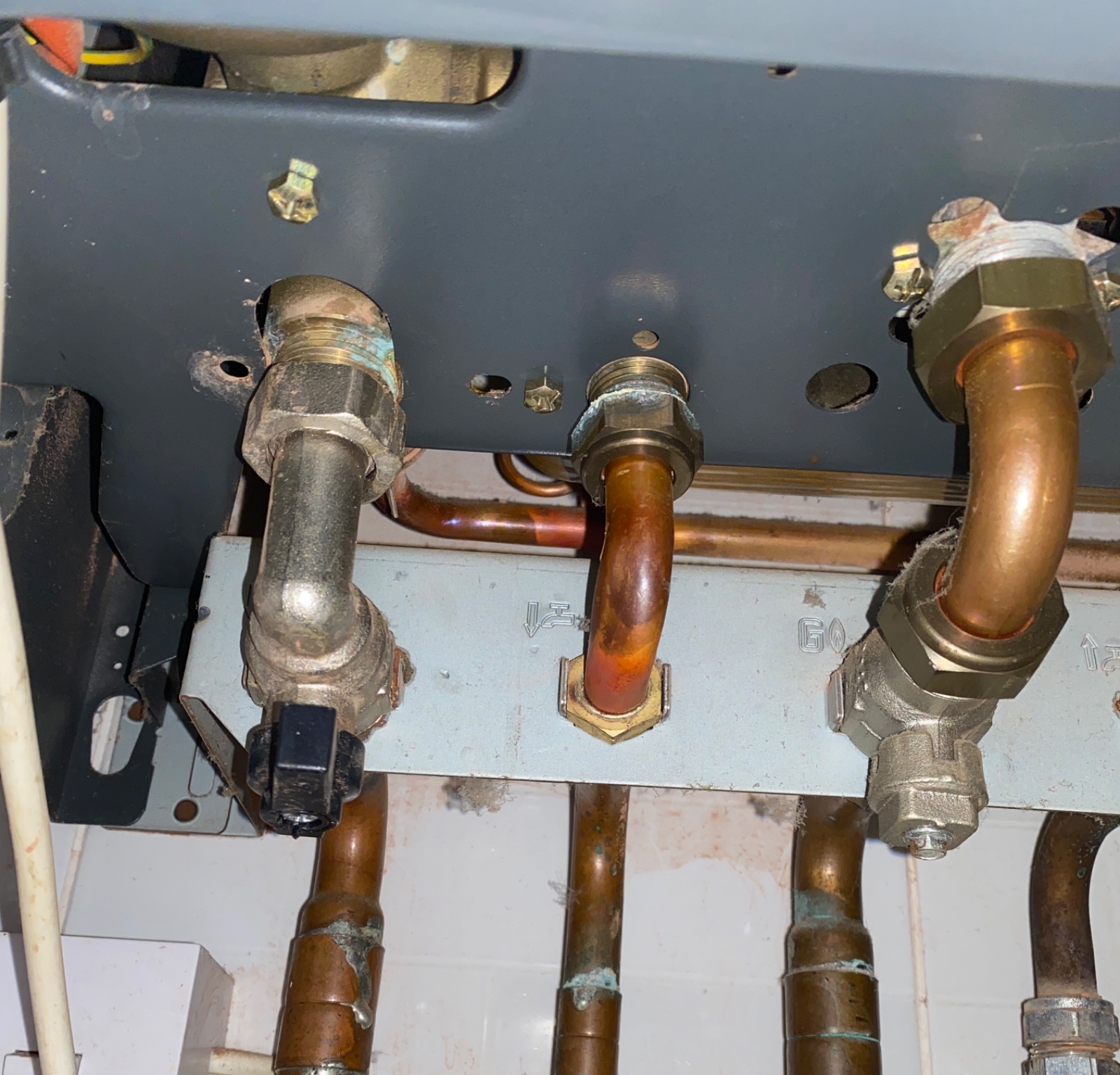

How to find value to repressurise Potterton Proforma 24 Eco HE ? Could not locate the two valves. Thanks in advance
31 Jan 2026
5
How to find value to repressurise Potterton Proforma 24 Eco HE ? Could not locate the two valves. Have attached few photos taken. Thanks in advance
Yep, seen them left in cylinder cupboards too. Check just above the boiler as well.
My mums combi boiler is fitted in a cupboard at one end of the kitchen. The top up was fitted under her sink about 4 meters away at the other end of the kitchen, along with another pressure gauge.
My sealed system boiler is fitted in my loft. My top up point and pressure gauge is fitted in the downstairs airing cupboard.
Thanks. These pipes go down below. Them two blue values must be here. Have to move away dish washer and check
Usually, yes, but then again...
Will check every where else and see. Why are they installed so far away from the boiler? Only helps to control ‘em within pressure needle’s view
