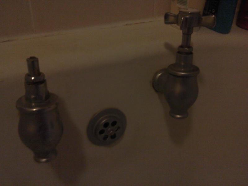

Hi i have snapped the handle off my bath tap and i would like to use a conversion kit for now(money is tight)is it possible,is it easy and also what size do i need.Any help would be great......thanks
They are 3/4" globe taps and they've been obsolete for years!
The problem that you're going get with conversion kits on those old taps is that the spindle won't be long enough and will run of of thread before the washer makes contact with the seating - I think you could be struggling with that idea.
If you've not much money try at your local scrap yard for some old fashioned big 3/4"bath taps, they don't have to be the same globe tap either as long as there 3/4" you sholud be able to just swap the tops.
Good luck,
servotech
Pegler have 36 pairs in stock.
Bristan show them on their website in 3 styles.
Bristan 1901 look closest to yours, Spud.
