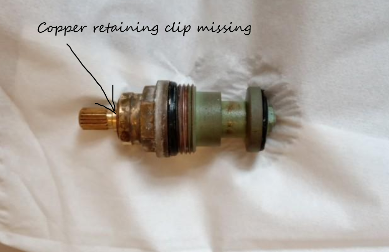

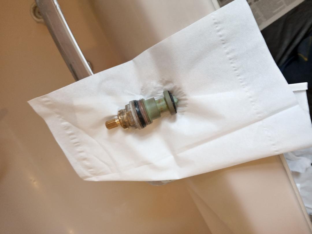

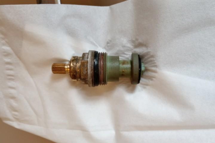

This is the picture of the gland I removed from my bath tap, which will fit a so called 3/4" rubber washer, but I find it difficult to find a similar gland to replace my old one.

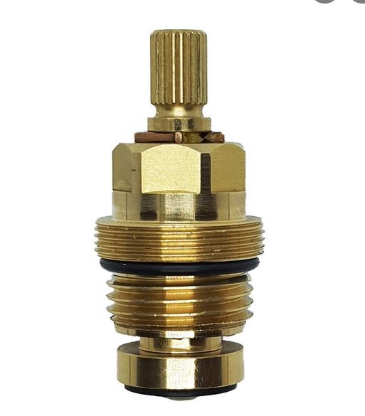

There's usually a retaining clip on the spindle just below the spline, yours seems to be missing, the spindle needs to be pushed back up
and the clip fitted.
Well spotted. That must be why the tap feels slightly loose when I turn it. I'm going to take a retaining clip from another gland and fit it on this one. I don't know if it ever came like this or whether the clip came out. Many thanks.
