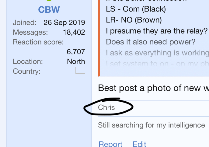

It’s Chris, no worries, glad you got sorted/figured it out. Best wishes to you too! (I’ve added a screenshot for future reference, that’s my “signature” and others have one too.
