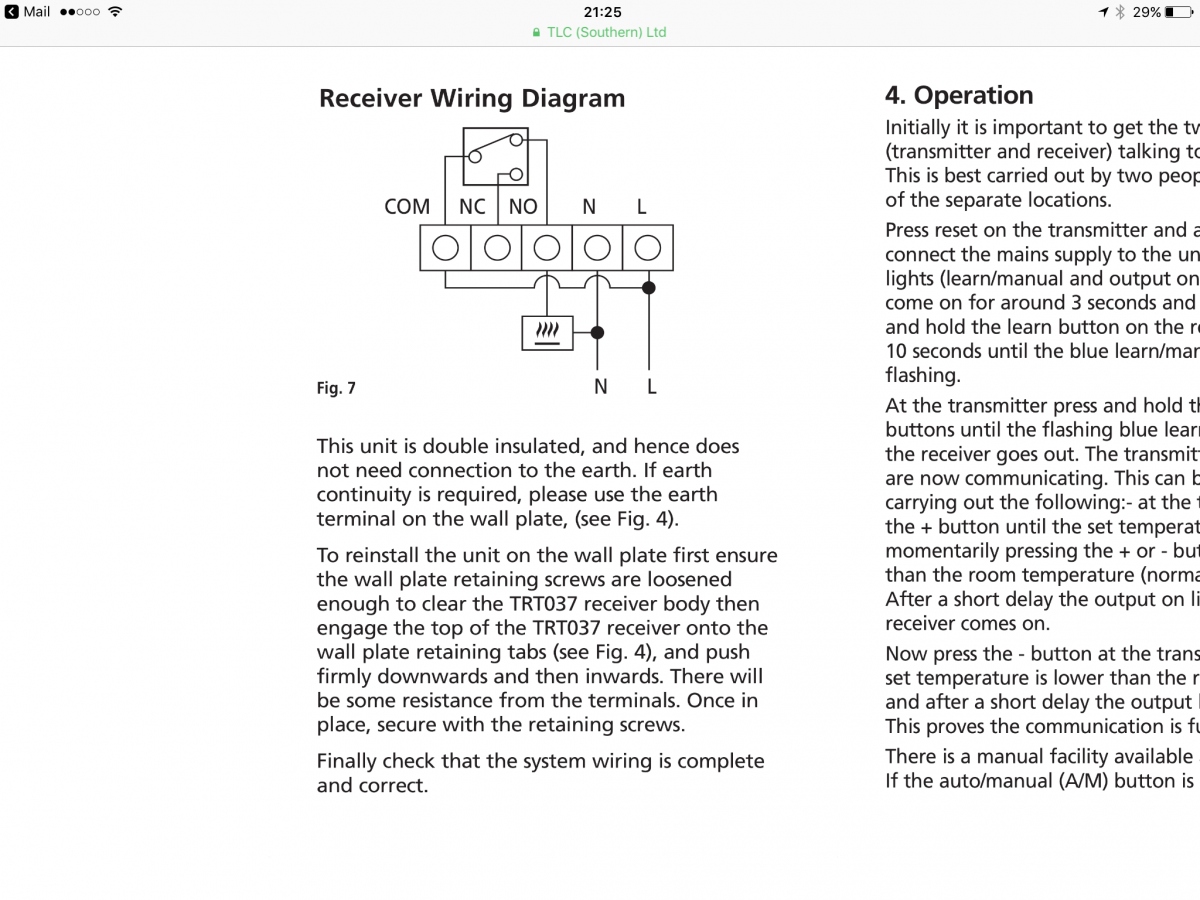

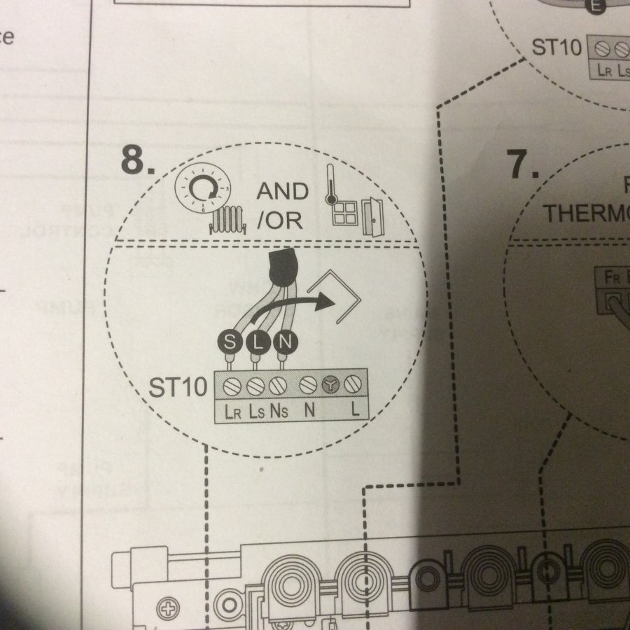

Hi,
I have a trt037 wireless thermostat. My boiler says to wire to the LS,LR, and NS. And my reciever has these connections com,nc,no,n,l.
I have attached pictures, would someone kindly advise me please.
Many thanks for your time.
Ian.

Make sure power safely isolated before obviously.
The thermostat needs live and neutral to power it, you can take this from the live supply terminal LS and neutral NS from boiler.
Put a link wire between L and common on the thermostat and connect between no (normally open) terminal on thermostat to LR (live return) on boiler.
The boiler might have a small link in between LS and LR if you don't have any time controls currently, just remove that if you do.
