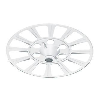

I really need to insulate my bathroom better, as it's over a garage. One obvious area is the garage ceiling, which has a thin bit of polystyrene glued to part of if. Better would be some thick Kingspan sheets, but how to attach them? The ceiling's smooth unpainted plaster, the Kingspan is shiny silver on it's sides. Will No More Nails do the job?
We generally use insulation washers
And very long screws (up to 300mm) to go into joists and/or rafters. Adhesives can always fail

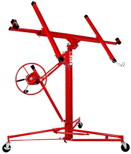

Can be a 1-person job with the help of a (hired-in) board lifter:

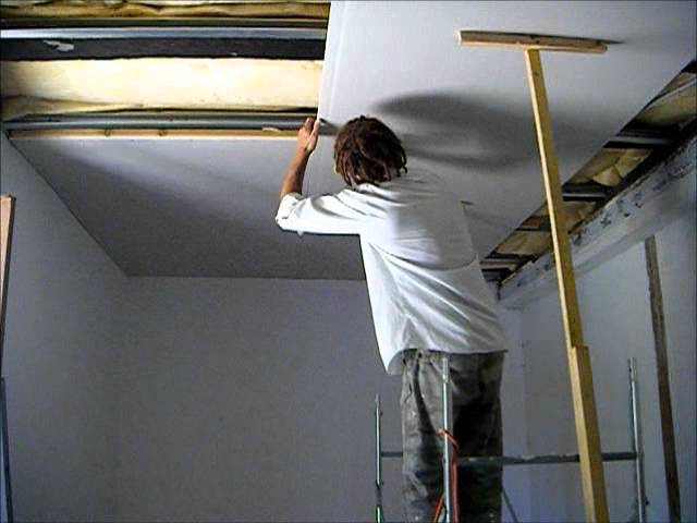

If you do it 2-handed without a lifter make yourself one or a couple of board supports out of 2 x 2 CLS or even slate lath:
