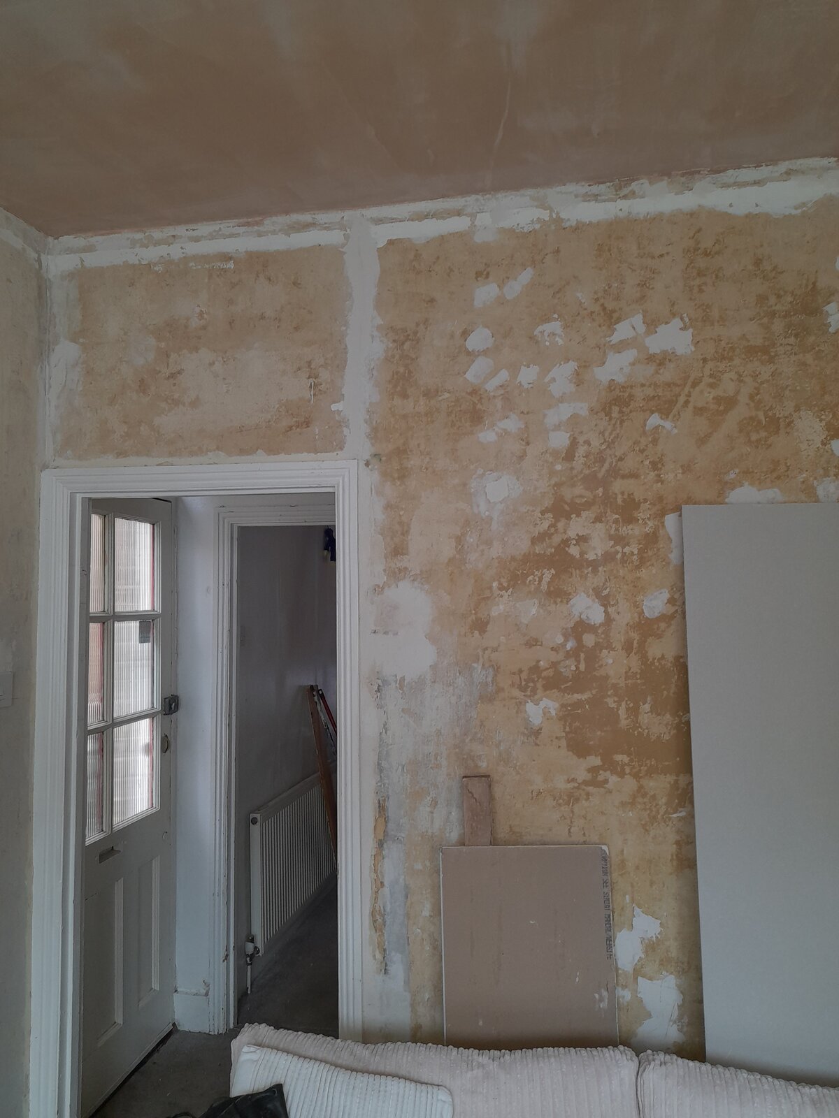

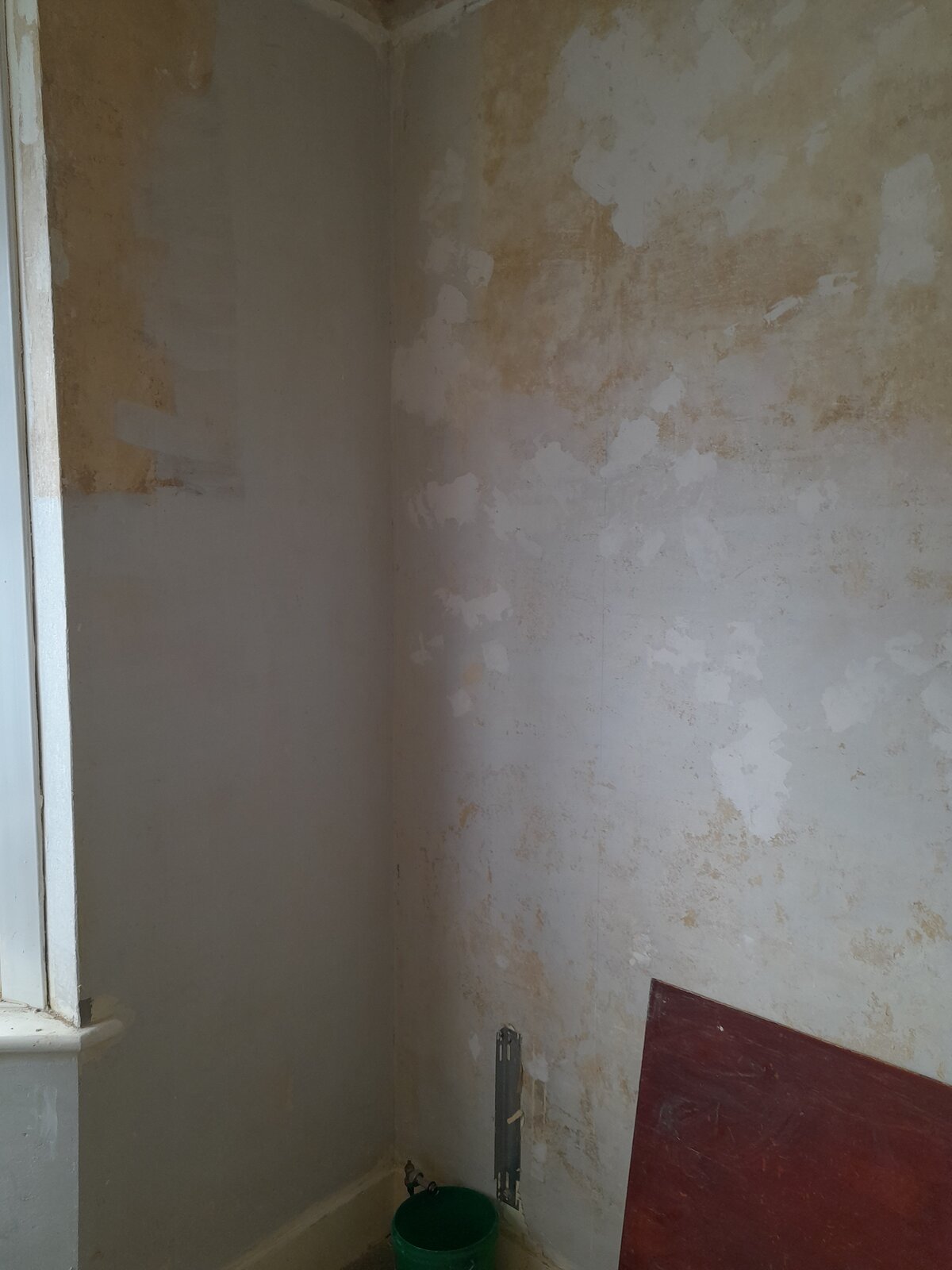

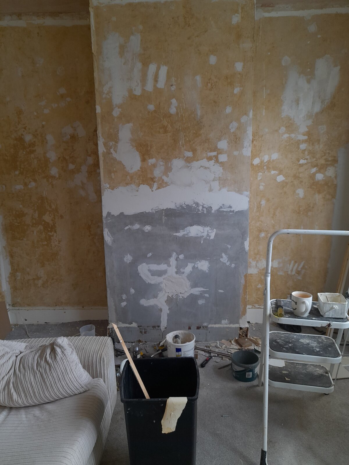

Stripped lining paper off and filled lotsa holes/cracks but, as you can see, the plaster is all different colours and materials probably. What's thr best way to prepare this for painting. I don't wanna use lining paper so is there a base coat that would do the job or should I go to the expense of getting the walls skimmed?

The colour makes me think it is an old house that has been distempered. See if you can clean a patch with kettle hot water
Distemper is unsatisfactory to paint and will need lining paper. It is hard and slow to clean off.
Tough.
That's a shame. It is an old hous. I have used Zinisser paint in the past to block stains. Is this not possible? Failing that, would skimming be an option?
Yes. Plastering is expensive. I just had a couple of ceilings boarded and plastered and got little change from £1,000.
I guess I should establish whether or not it actually is distemper. Is there any definitive test I could do?
