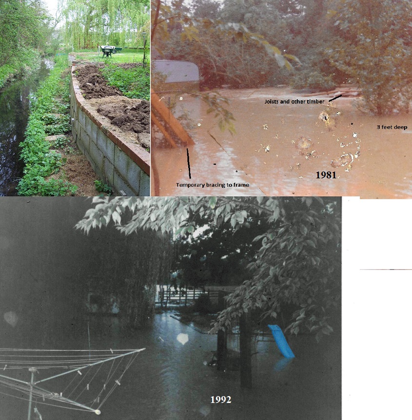

We bought a plot of land next to a babbling brook in 1979. The flood risk quoted ( which we did not check ) was once in 100 years.
These only lasted a few hours before the stream dropped back down. Fortunately the house was not affected.
And two less invasive floods as well. The wall was built to prevent further erosion of the bank when the stream was swollen by rain.
