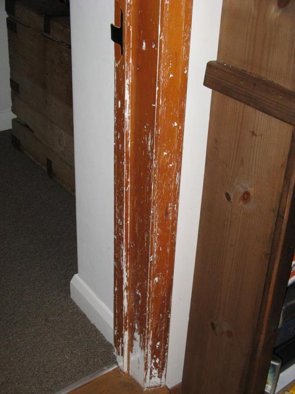

Thanks for the advice. We have made a start on a couple of door frames now. As mentioned before, in some places the old paint peels off in large strips close to a foot long!!! Comes off like a layer of latex (ahem, not that I'm overly familiar with latex).
In other areas it seems well stuck down. I've borrowed a heat gun but that does not seem to be helping. Where it comes of easily, the heat gun actually makes it tougher and makes it sticky (and the sticky mess then just smears across the wood). On the stubborn bits the heat gun isn't helping much....
I've taken a couple of pics:
In this one you can see how the heat gun has smeared the paint compared to the area above where the paint peeled off with a scraper leaving the bare varnished/stained wood beneath.

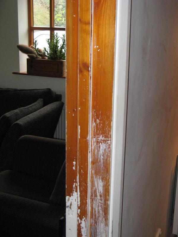

In this one:
we got off as much as we could without the heat gun. At the bottom there's some paint that was hard to remove. On other frames these sections are larger (where the paint was harder to remove).
So I guess my questions are:
- is it ok to leave those such areas painted?
- should I use I primer/undercoat over the whole frame, or different products depending on whether the frame has paint on it or not?
- Is primer even necessary seeing as the "bare" wood is not really bare, but is actually varnished/stained?
Just to be clear, I know I'll need to sand and clean them prior to painting.... And we just want to restore them to how they were - white satinwood type finish.

Have you tried a belt sander with a really low grit on the stubborn bits?
If you leave some paint on you may just need to use a bit of filler to taper the high spot level.
Paint does not adhere well to varnish so its important to use a paint that has good grip. Coverstain will do this and also seal the varnish to prevent any bleeding.
I always reckon that you should sand off anything rough or loose, but if it's adhering so well that it's difficult to get off, it's adhering well enough to paint over.
