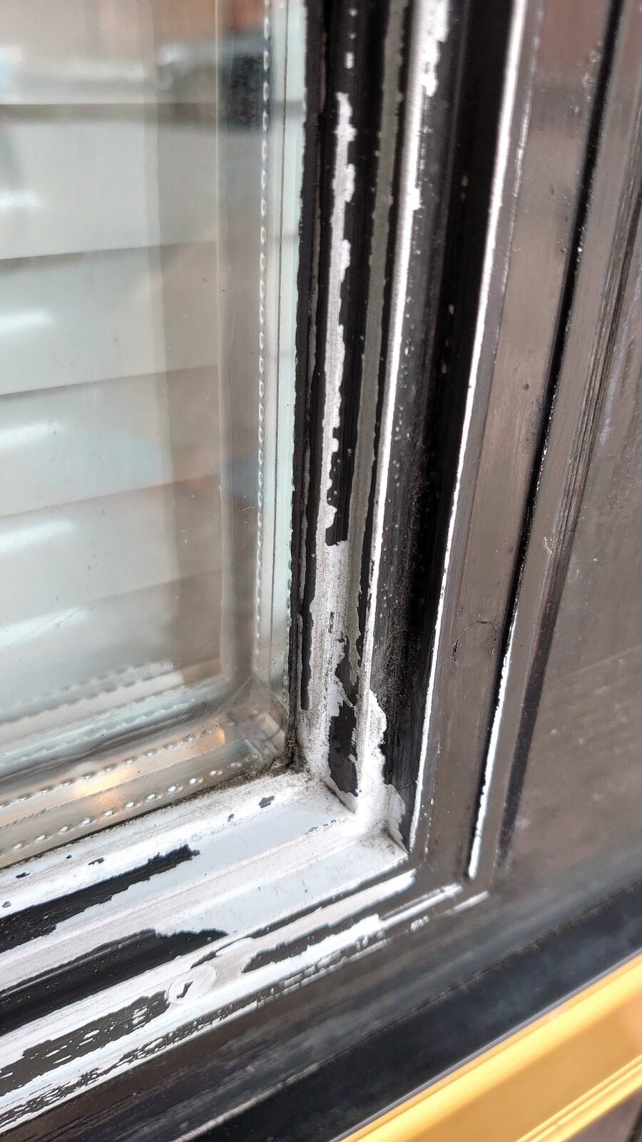

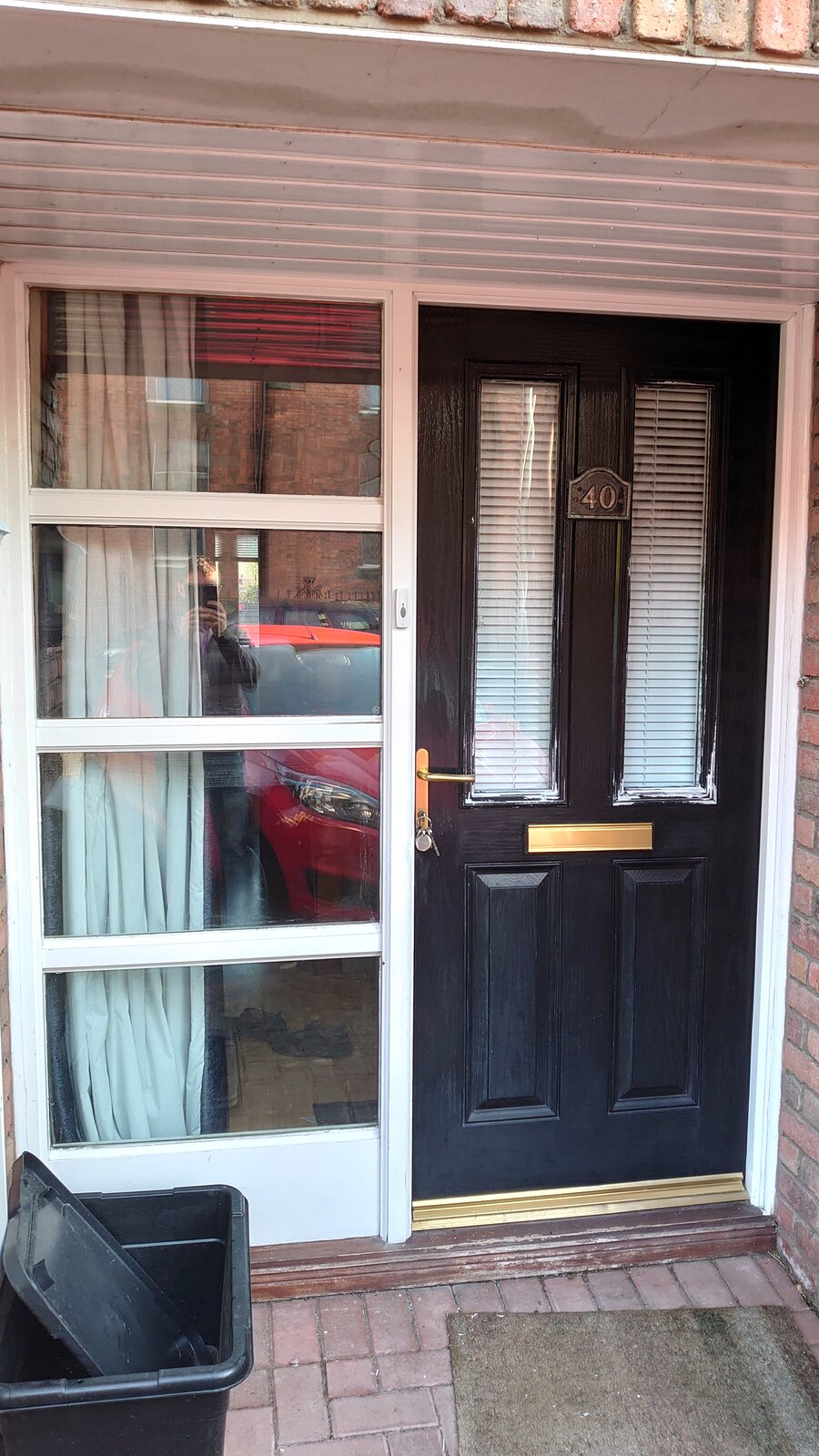

Front and back door are painted black, and frames white.
Doors are wood and have 2 glass panels side by side. Paint has been peeling, mainly just on the trim around the glass panels on the front door, which looks to be PVC, not wood.
Doors probably were painted 9 years ago before moved in.
Only ever painted walls so what is the best way to tackle this?

Mainly just around the window trim on door.
Minor flaking at edge of one glass panes to the left side of the door, but believe that that particular pane of glass was replaced at some point, hence paint damaged when removing trim to replace glass
Photo added, as flaking on the door is just the trim around the window, could whole door need primed or just do the trim? Trim is white when paint flaked off, sanded off flaking paint on trim already
That's the only window at the side with flaking, same at inside of window so probably cause by glass being replaced.

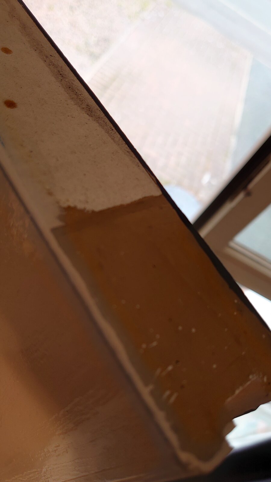

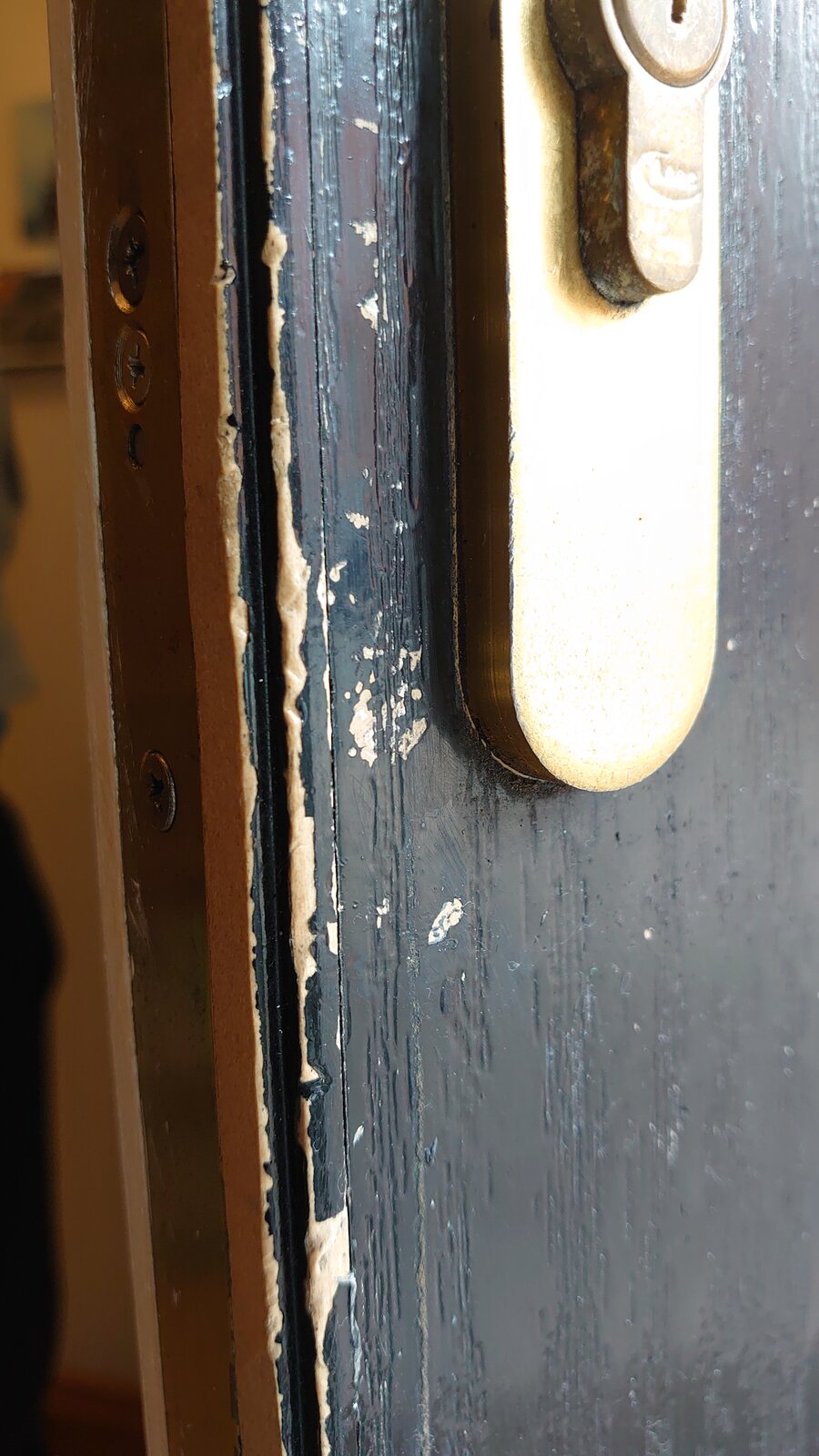

Can you show us the edges of the door at the side and top please. Close up of any joints. And of peeling patches.
I am not at all sure what it's made of.
Door looks to be mostly, all scrapes and marks reveal wood beneath. But the trim around the door windows is white underneath, probably different wood that the door, looked plastic at first
