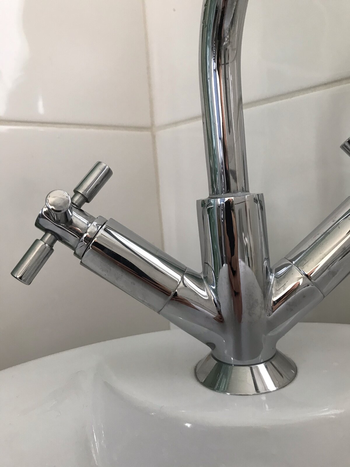

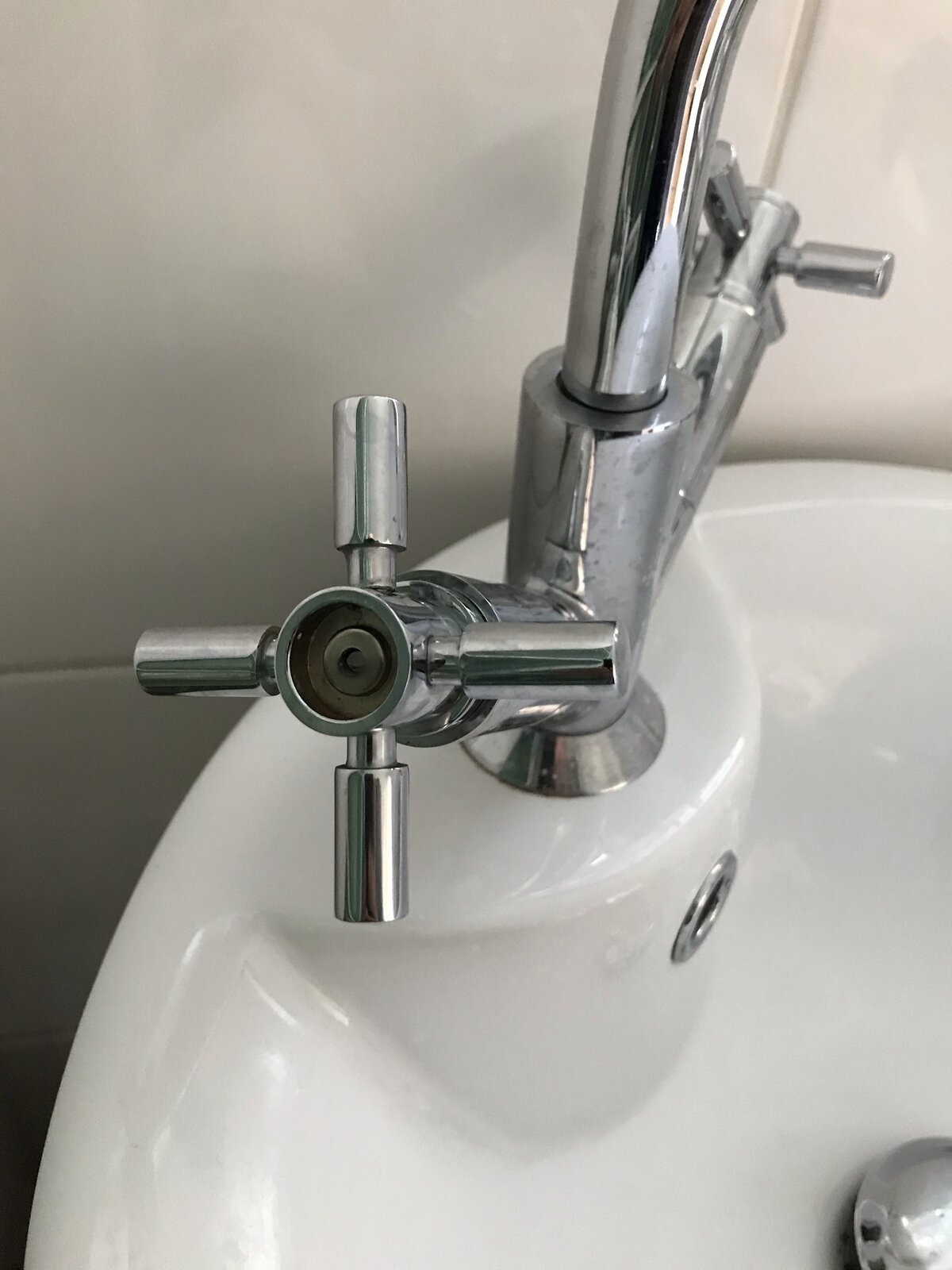

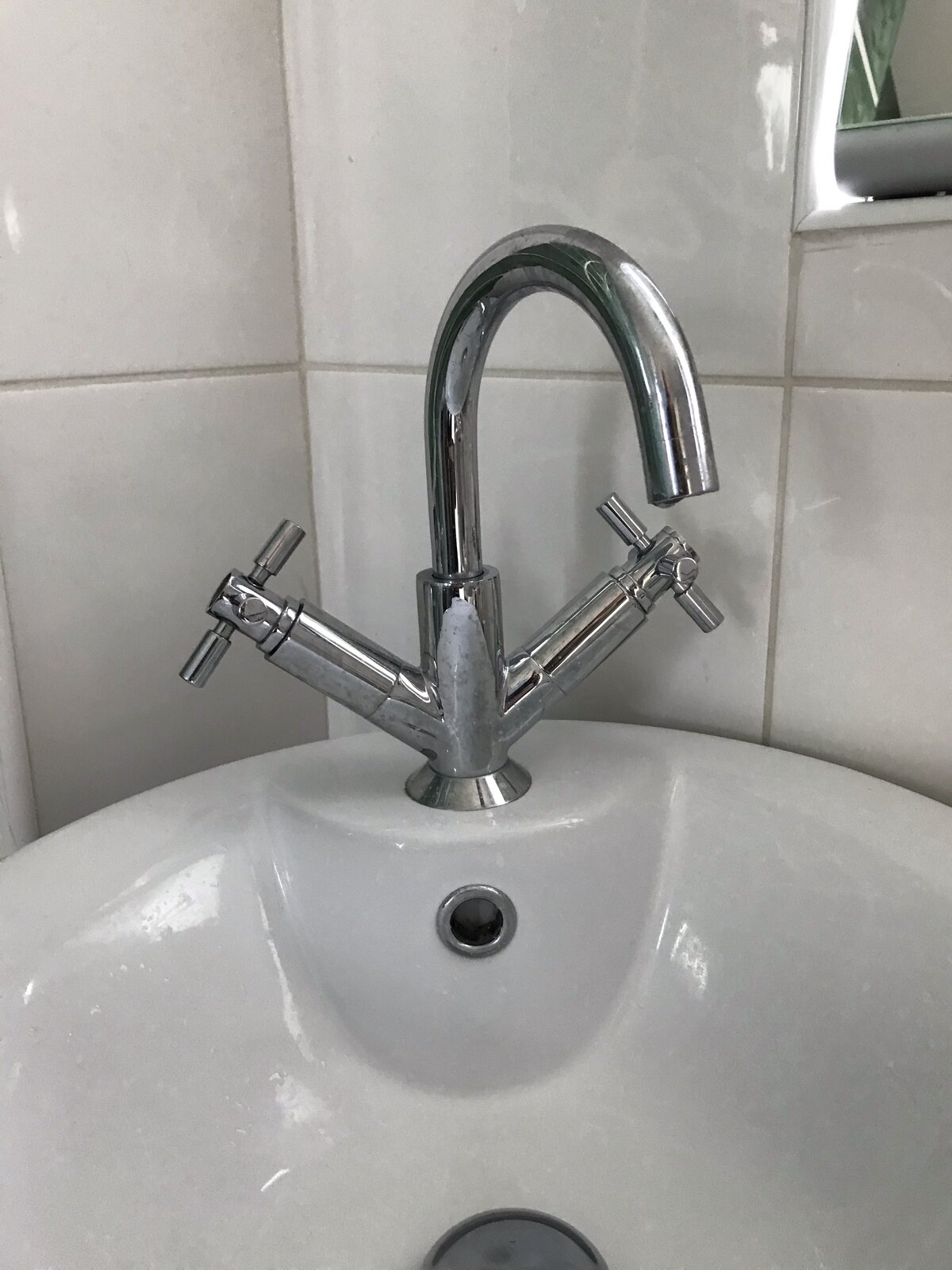

Hi. The valve has given up, so time to replace it but.... I cant work out how to remove the existing one from this tap! Any guidance appreciated. Cheers.
tap3.jpg tap2.jpg tap1.jpg !
I expect one of the four branches of the handle unscrews to reveal a grubscrew beneath it, but be warned that unless you know the make and model of your tap you're going to struggle to find a replacement cartridge to fit. There are literally hundreds of options available. Might be better off just replacing the tap...
