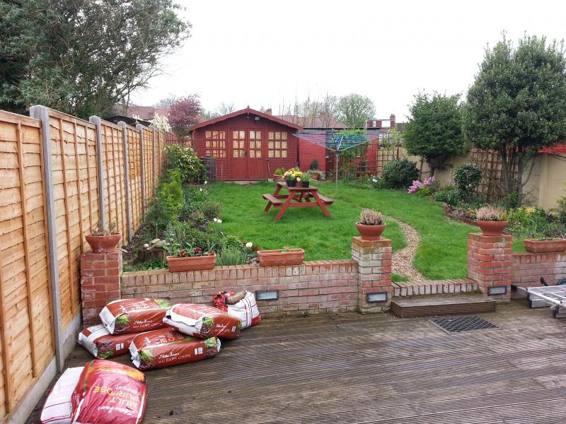

Hello,
When I got the house it had a large (4mx3m) wooden shed already built up from the previous owners. I am trying to sell it so I can build a bigger, brick shed in its place. It seems to have electrics and insulation and everything, how easy is it to dissasemble this thing in a way that someone else can assemble it?
Picture for reference:
I can get pictures from inside tomorrow when its daylight if needed.
It's common to see sheds for sale with the addition of "buyer dismantles" which is probably the easiest route to go down.
Should you want to take it down yourself you will find these types of sheds are built as panels and fixed at the corners with either screws or bolts. You may be unlucky and find it has been boarded over on the inside which may be hiding the fixings. You'll need help with a shed that size.
