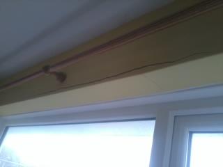

Hi,
That time of year again where I am thinking about doing some odds and sods around the house.

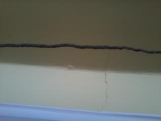

When we moved into our current house (5 years ago) there was a small crach above the window in our main bedroom. This crack was approx 20cm in length and was 2mm at the widest part. Over time this crack is now approx 1m in length and 5mm at the widest part.
How on earth do you repair something like this? Is it possible that a relative amatuer can do something like this? Or will removing the lot and replastering be needed?
I have put on a couple of pics if it helps!?

Looks like it is all loose! not a big job to sort out if you have some plastering skill.
Couple hrs work to a spread...
Hi,
Thanks for the quick reply. I have no plastering skill unfortunatley. Would I need to remove the lot? Or can the existing be repaired. Excuse me if the question is ignorant, I work with computers and this a new world to me!
It looks like the plaster has come away from the lintel , if it sounds hollow it will need to come off.
I agree with Alastair, it'll need to be taken off. I'd remove "all" the plaster on the lintel, (the underside and the face) all of it. Once the plaster has been removed, i'd give the lintel a clean off/damp down, then bed on an angle bead along the front edge of the lintel with 3 or 4 dabs of multi finish, then let it set. Once the dabs have set, give the lintel a damp down again, brush on a coat of pva, then re- plaster the whole thing out flush with Bonding Coat plaster on the front of the lintel and under the soffit. Let it all set up, then finish it off with with multi finish.
I would suggest not to be tempted to stick polyfilla in there and repaint.
As roughcaster and Alastair - you need it repairing properly.

Older houses sometimes had a wood lintel.
Be cautious about removing any angle bead or you may end up disturbing the wall surfaces at either end of the angle bead.
The ceiling seems to have a shadow, or is it coving that i'm looking at?
I don't think there will be a bead along the edge of that soffit, Ree, in fact i'm certain, because you can see there isn't. I would also say that in my opinion, the lintel would be concrete, and because there were no bonding agents and no bonding plasters years ago, the thickness of plaster, sheer weight, and lack of key on the old lintel, would have caused the plaster to drop away and split. That, plus the fact the plaster would have probably been sand based..
I would remove "all" the old plaster on the lintel, all the way across, to where it meets the brick/blockwork at either end, that way, you can be certain that all the loose/blown plaster has been removed. I would then repair it with a galvanised beading the way i suggested earlier.
